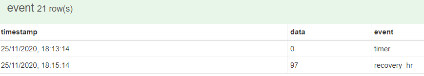

Also in the fit file, you will find the Garmin “recovery_HR” metric which is heart rate 2mins after the athlete stops their activity - see below screen shot from www.fitfileviewer.com. (To get drop in HR over those 2mins need to take the HR data from the final data point of the recording.) This could also be an interesting metric to include / track long term in the Fitness page.
