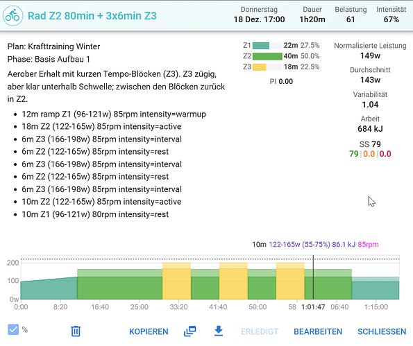

I have this workout and use it in MyWoosh (Calendar). When I´m riding, the ramp at the beginning ist not used:
Is there something wrong with my workout desc.?

But in my screenshot you see, that intervals.icu display correct the ramp. Maybe the connect to mywoosh is the problem? Maybe myWoosh expect another syntax for ramp?
You use
-12m ramp Z1
That doesn’t work in Mywhoosh as I said above.
Change it to
-12m ramp 40%-50%
and it will work in Mywhoosh.
