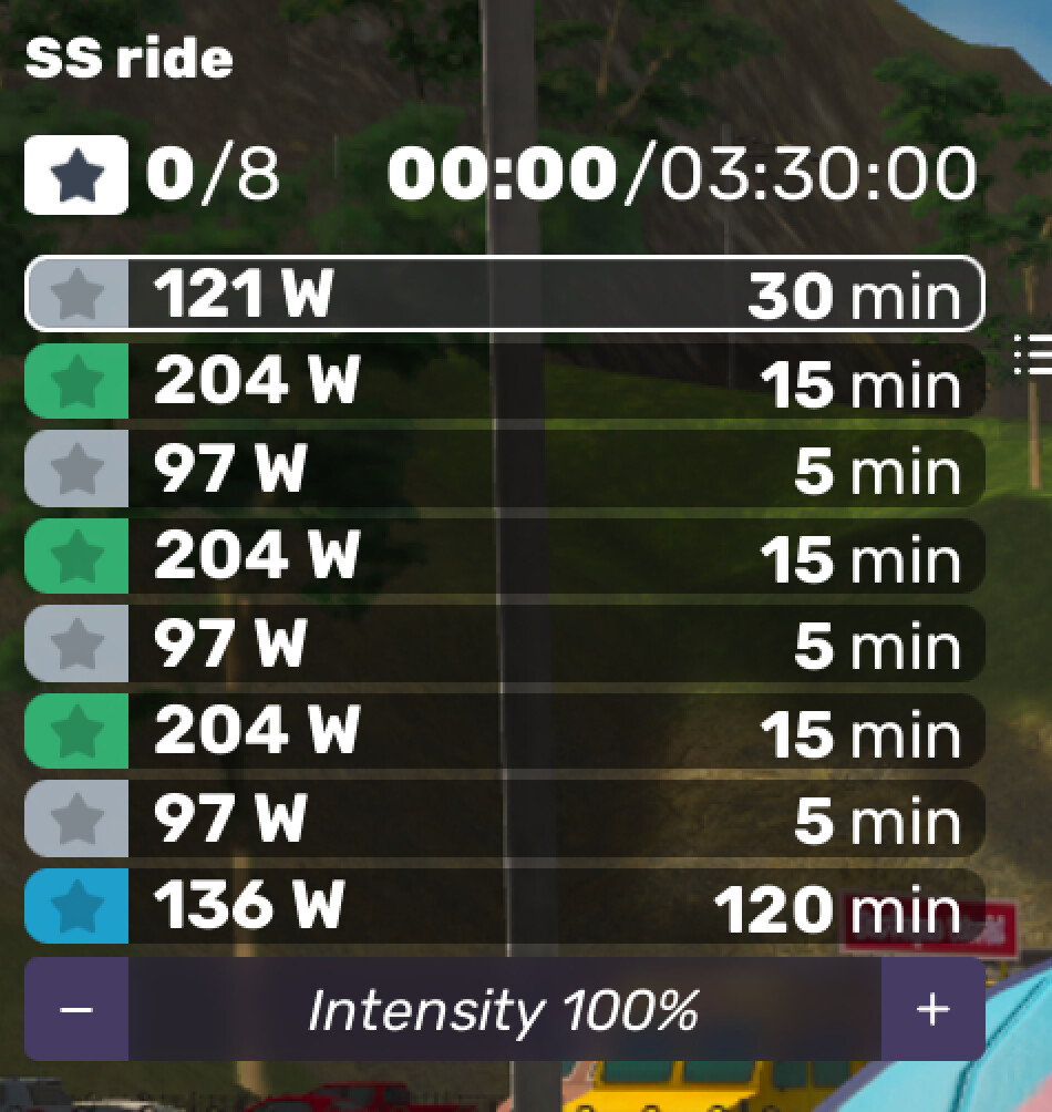

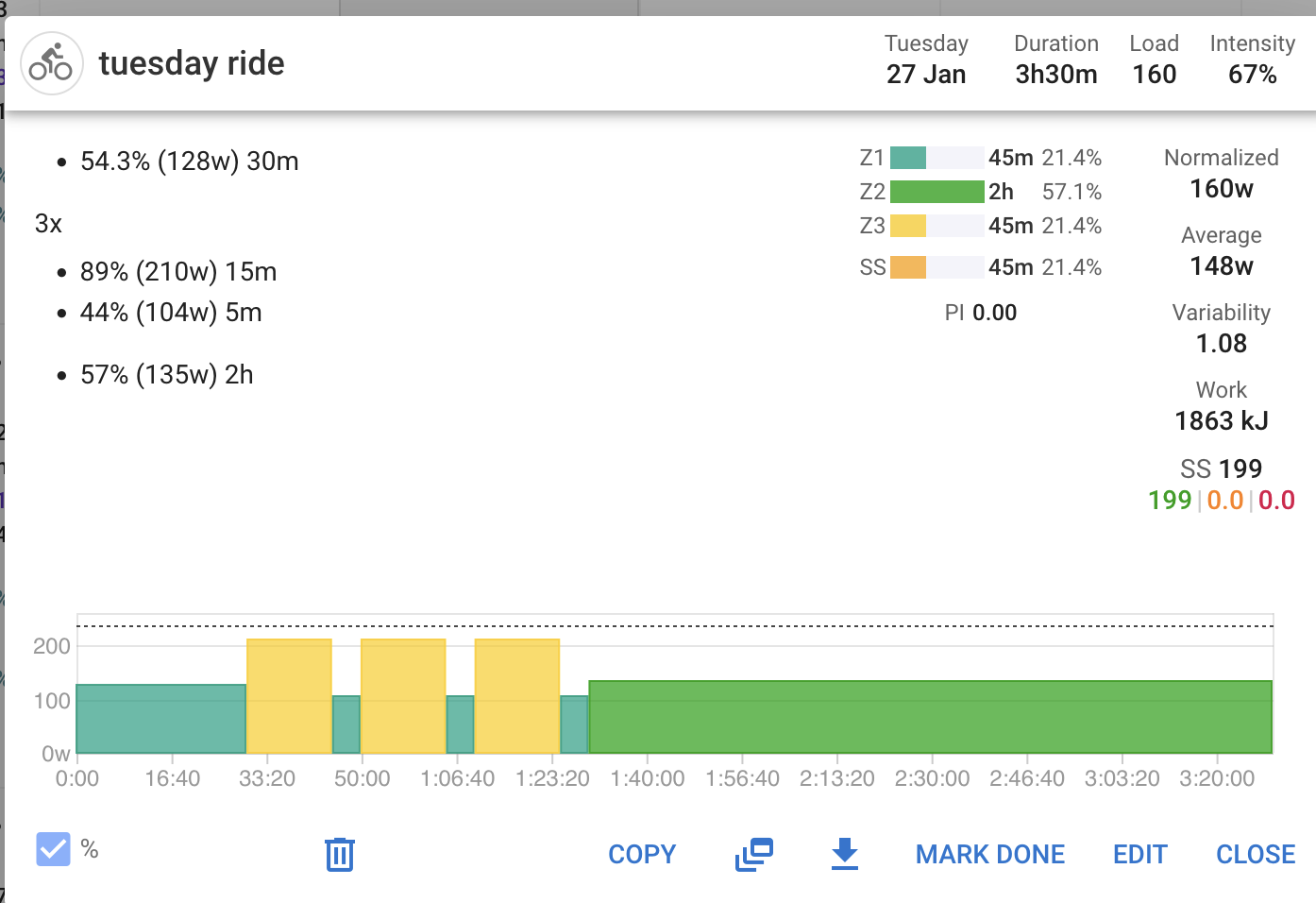

UPDATE: It works to leave out numbers from the headline of the workout part. Even if you put in a number, write more text, and a number again, MyWhoosh will read it as it was one single number consiting of two digits. For instance:
“Warm up 1st part 3x” would be read as: “13x”

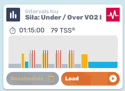

In intervals.icu it renders correctly:

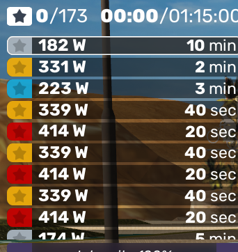

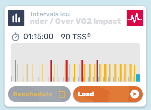

In MyWhoosh it gets parsed incorrectly (there is 173 intervals):

It might be an issue on the MyWhoosh parsing side, but I can’t be sure which side is responsible, so I am just letting you know.
The problem also exists if a number in block title is followed by some letters e.g.:
Powtórzenia siłowe/VO2max 4x
40s 100–105% (315–330w) 55–65rpm (RPE 7–8)
20s 120–130% (378–409w) 90–110rpm (RPE 9–10)
Was already reported and the issue is at myWhoosh. They simply strip all non-numerical characters. Any number is retained no matter where it occurs on that line.
Sure, thanks, I tried to search for this issue but did not manage to find it on the forum.
No problem, I simply remembered a similar post and the response from @Gerald . With that knowledge, a search quickly returns the exact thread.

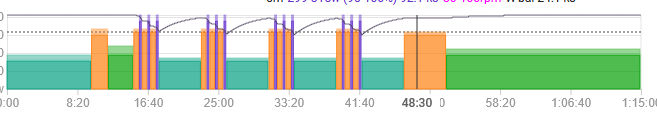

Hey, I’m new to mywhoosh and would love to use my intervals.icu plan. For cycling everything works fine but for running it doesn’t work. Can anyone tell me if this is a mywhoosh or intervals.icu issue?

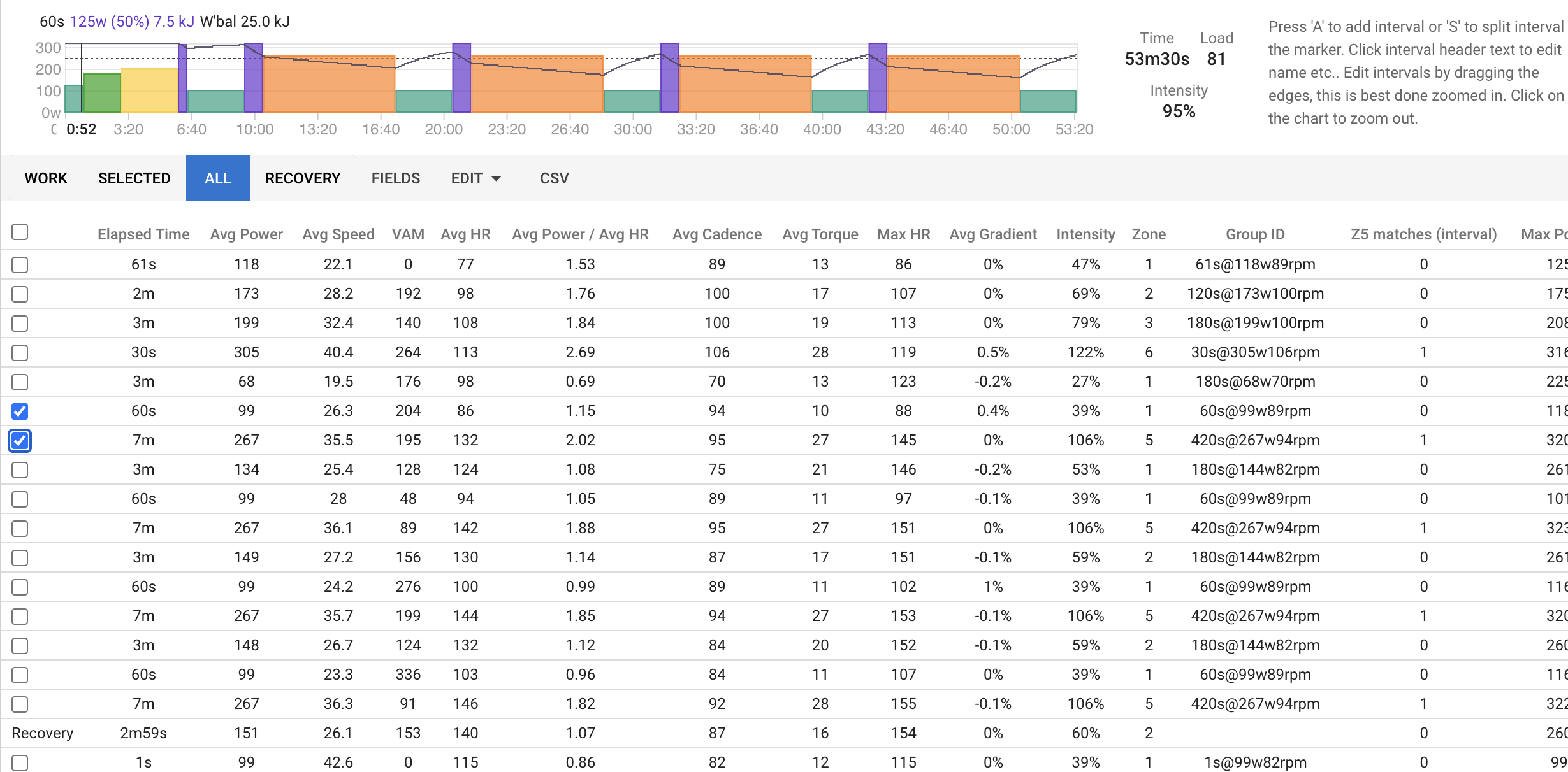

not sure if user error, or mywhoosh sending bad data to intervals.icu, or intervals.icu incorrectly interpreting the data received from mywhoosh.

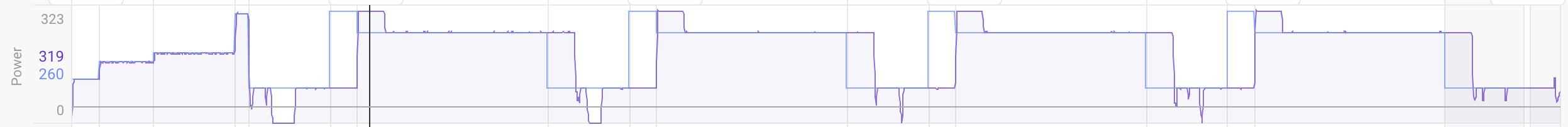

Whenever the activity is paused in mywhoosh (either i stop pedalling or click pause) the laps in intervals.icu report get messed up. Eg. those 60s purple laps should be 320w, orange 260w.
Is this a well known glitch perhaps?
