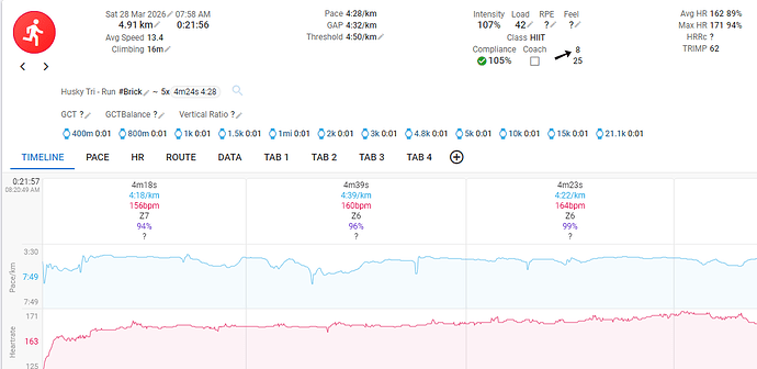

Multsport offset start seems to trigger instantaneous SBs

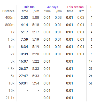

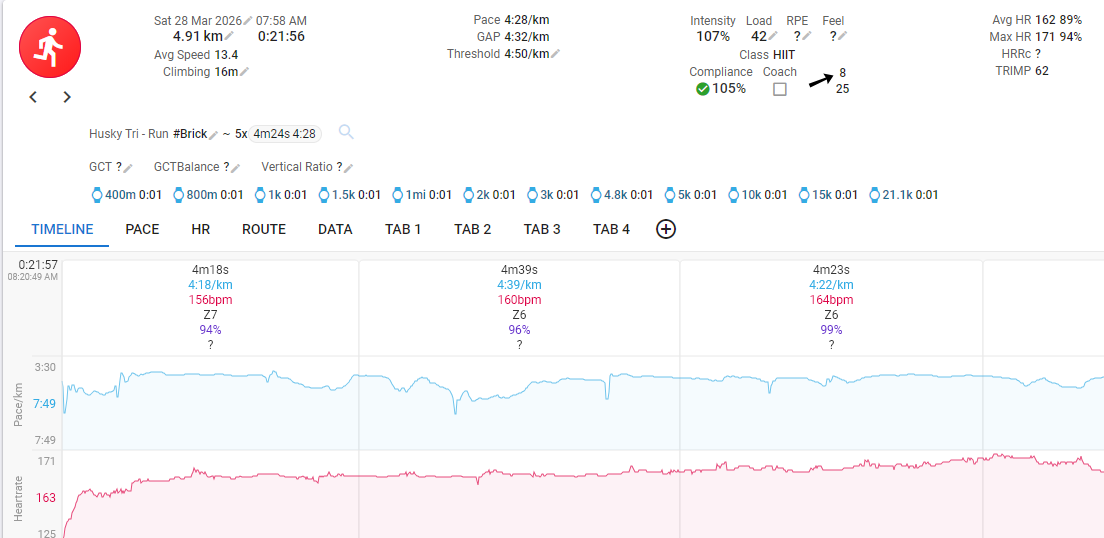

Hi, i have a recent multisport tri that seems to be acting a bit strange in terms of season bests. It seems to be using the already completed 21.6km as elapsed in the first 1 second. I have tried reprocessing (no effect). I tried to ignore the first 2 seconds which didn’t seem to work either.
I don’t think it was an issue on original upload. Maybe I caused an issue.

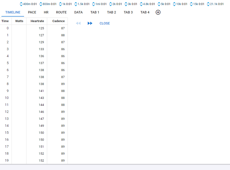

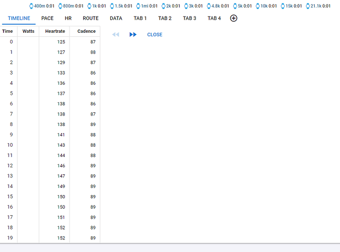

Can you fix the wrong second with Action > Edit Data?
Doesn’t seem so, it doesn’t seem to have the distance data. When I check the csv it does start distance at 21km.
This is fixed now. The bug was introduced a little while ago sorting out an issue with Concept2 rows. You need to re-analyse existing activities with this issue. The one you posted is fixed. Thanks for the report.
