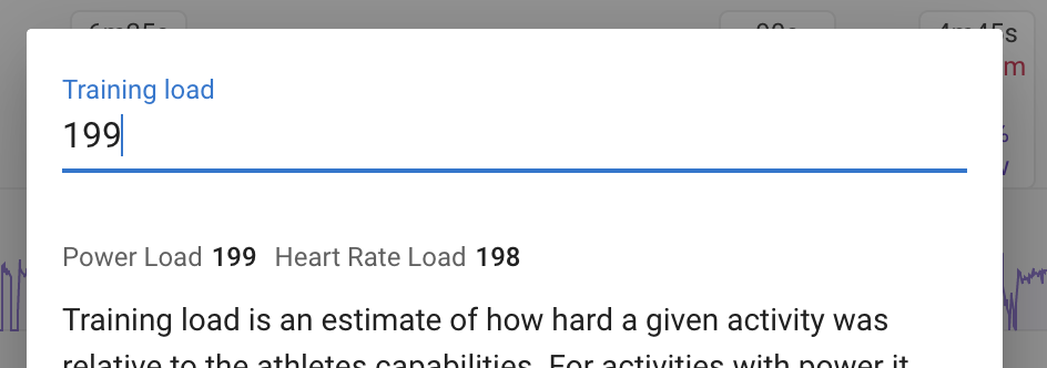

Hmm … spikes in power would normally result in higher TSS and hence load. If you click the load number it will tell you what the load would have been using HR. You can just enter that value manually if you think it better reflects your effort.

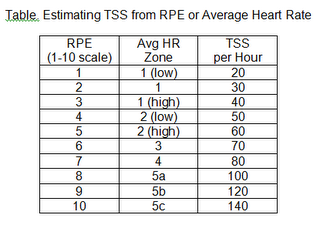

RPE might be a more helpful metric, it depends what you want to use load for.
Joe Friel, inventor of TSS, gives an easy way to estimate TSS based on RPE and duration.
