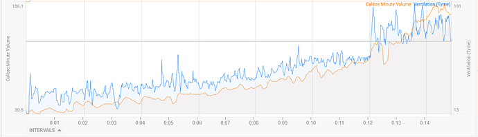

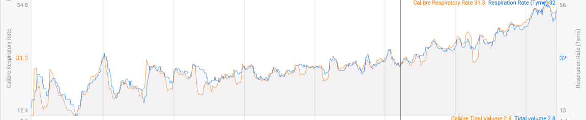

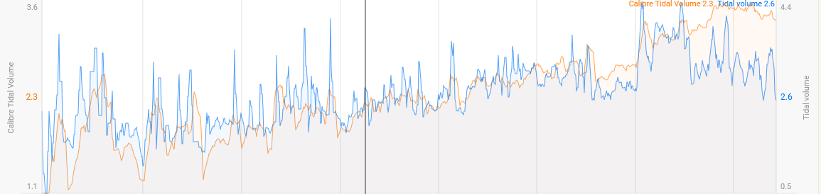

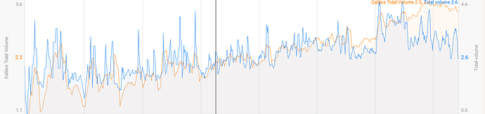

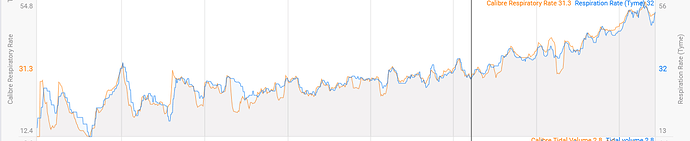

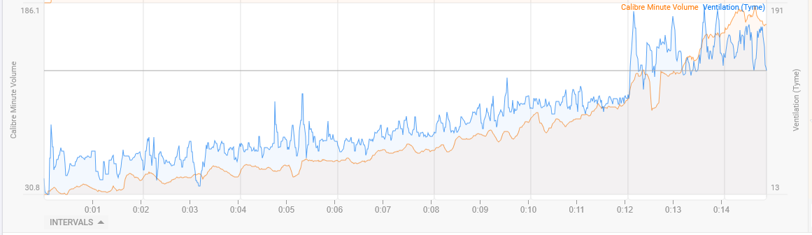

Using the methods i proposed i got:
Tyme vs Calibre Bio Respiration Rate
Tyme vs Calibre Bio Tidal Volume
Tyme vs Calibre Bio Respiration Volume
