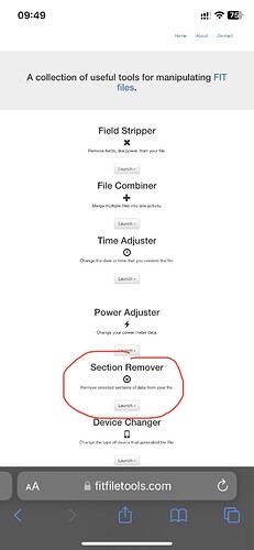

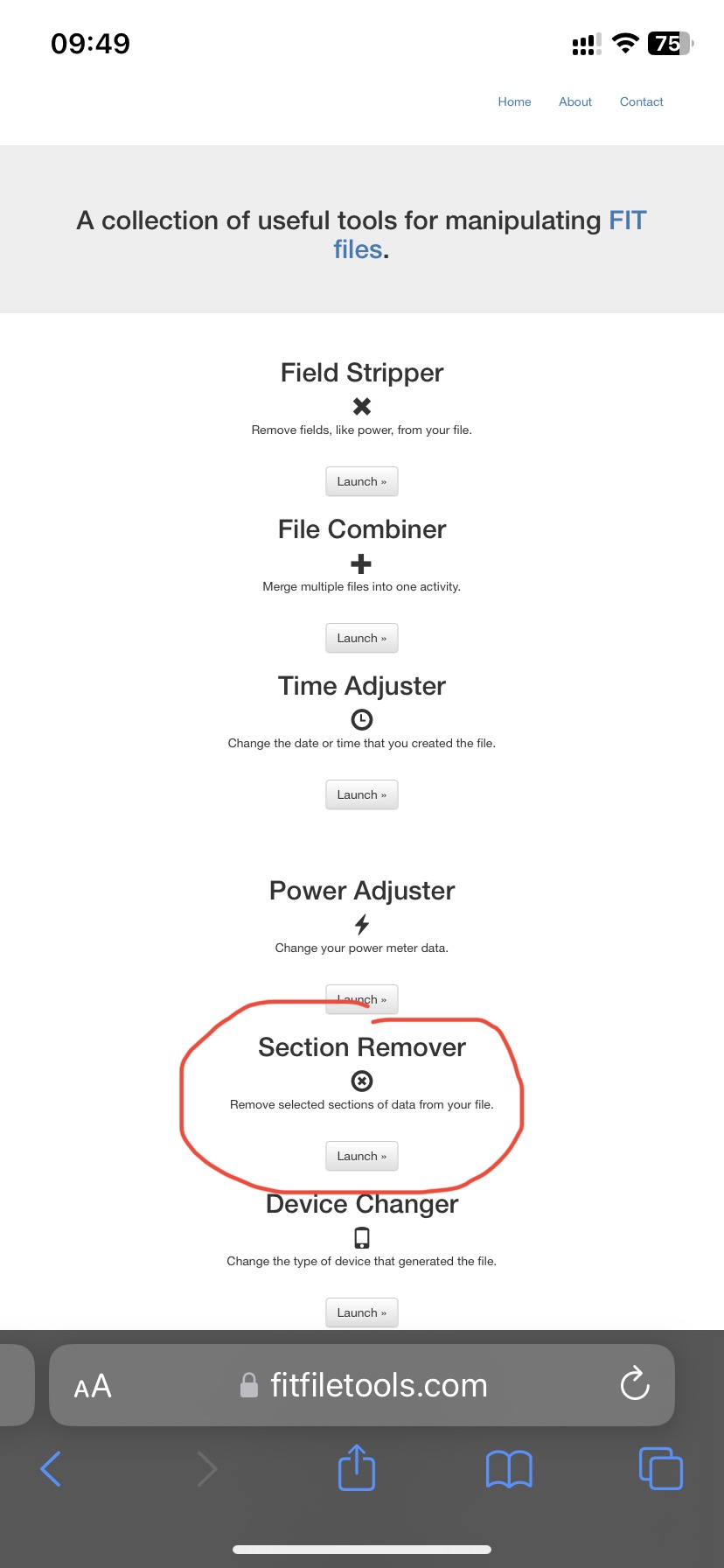

There can be a few reasons, one of which is that your activity starts before the satellites are fully connected.
To fix it, you can crop the first second or more. Upload to fitfiletools and then use the Section Remover option.

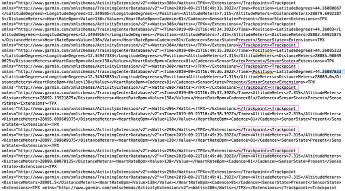

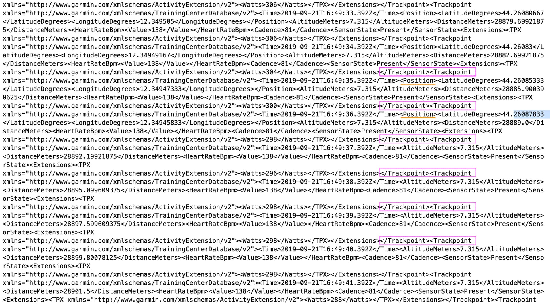

I did some investigation on the tcx file and found the following:
Trackpoints are marked.
Additionally Position is marked.
→ As you can see there are many Trackpoints with no Position. This is potentially the issue.
