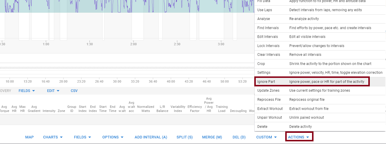

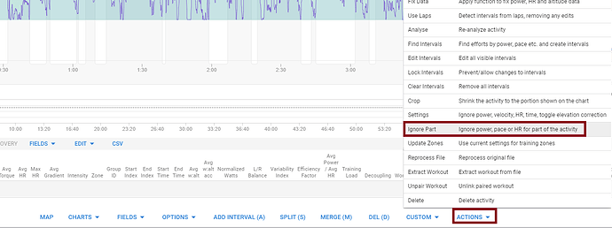

Open your activity
Scroll down to the bottom menu
Actions, then you will see this list.
Ignore Part is where you can remove a section of the activity, eg. your forget to turn off your recording at the end of the ride.
Settings ignore… allows you to ignore the whole activity.
