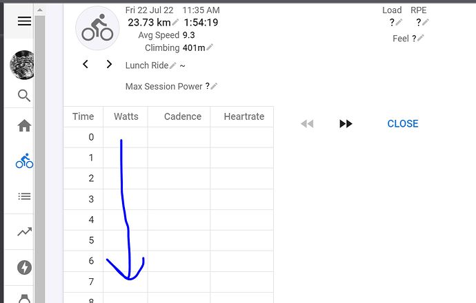

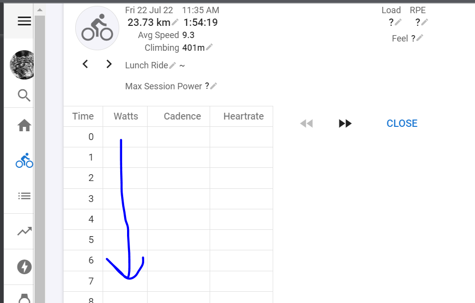

Open the activity on Intervals, then Action> Edit data
You’ll be able to add in power there

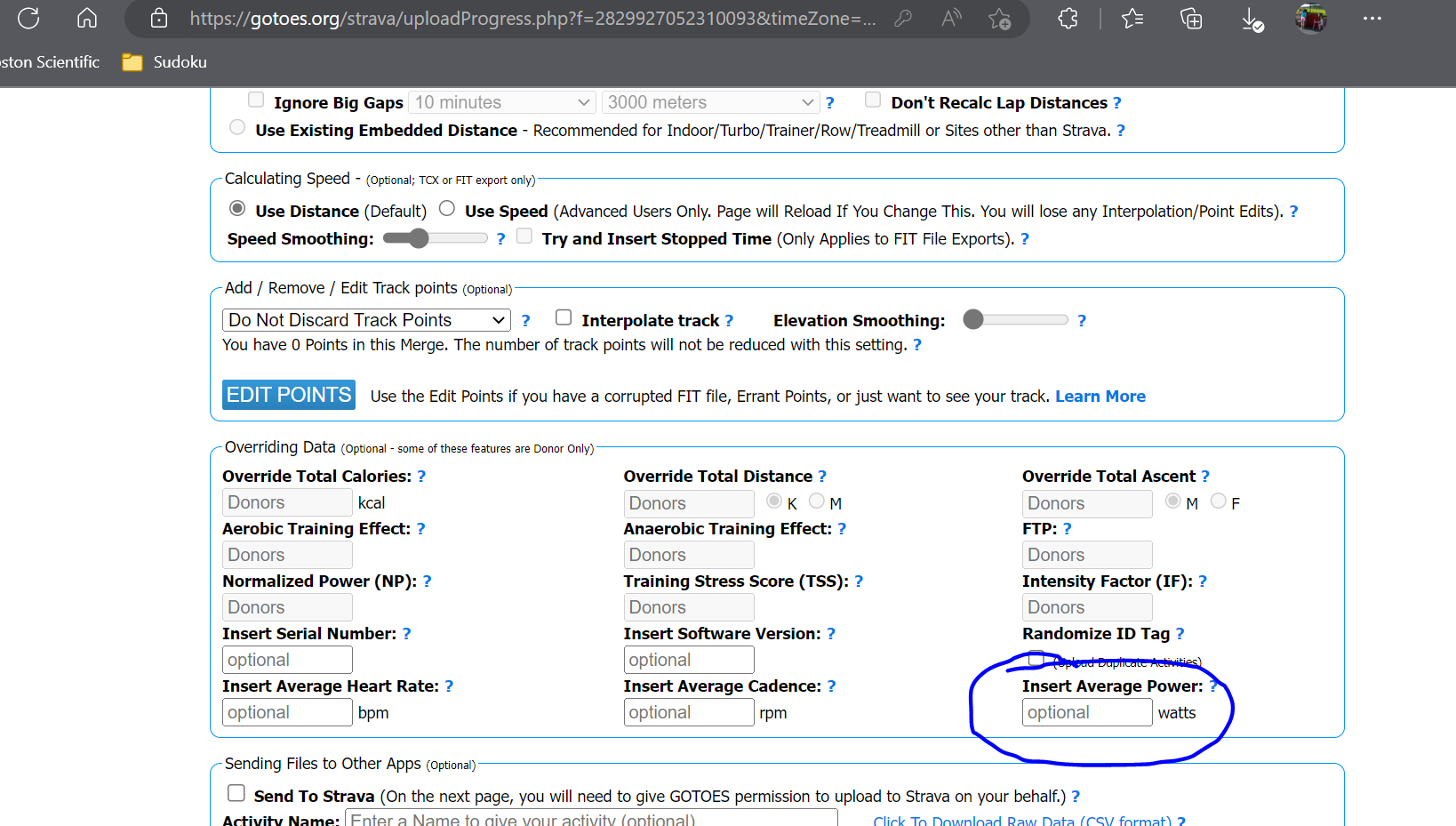

Or this might work, though I have never tried it
Combine FIT, GPX, CSV or TCX files for Garmin or Strava. Merge Heart Rate Power and GPS (gotoes.org)

thanks, I found Action → Edit data in the mean time as well. Unfortunately not practical. Editing power data for every second of the ride. Would need some kind of bulk editing. Perhaps same as the intervall creation window (e.g. 5min 200w etc…)
Will try the tool you linked and will report back!
