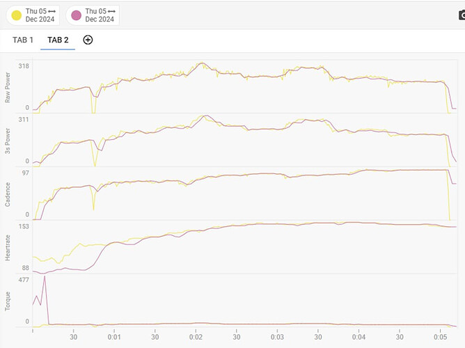

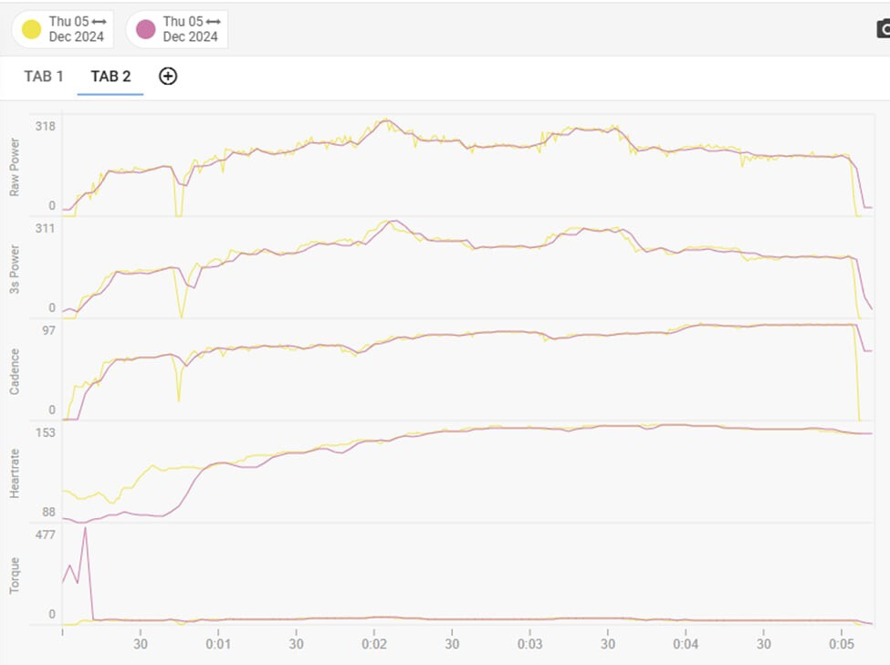

Favero Assioma PRO-MX compared to my Power2Max ngECO crank on my regular bike. Not as long of a test as was on the rollers inside which I haven’t been on since last year. In first picture, magenta is PM pedals and the drop in power/cadence is me reclipping my left foot back into the pedal. Yellow is the crank data.

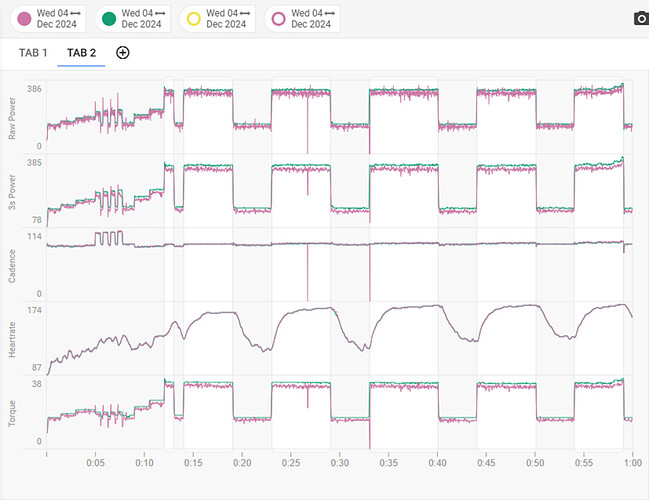

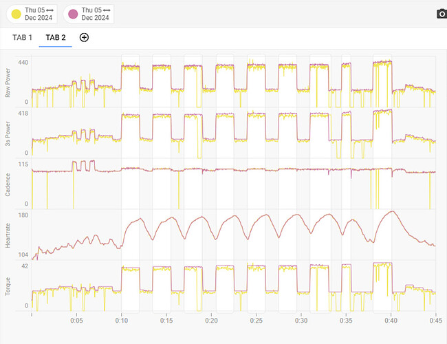

In second photo, magenta is crank data and yellow PM pedals. Early drop is me nearly wiping out. Not entirely sure what happened with the torque numbers in that second one.

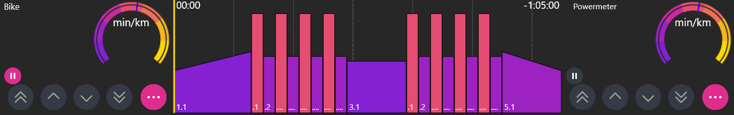

With the indoor cycling software from icTrainer.com, you can display the values from the Kickr and the power meter in parallel during your workout:
You can then use either the values of the kickr or those of the power meter for control and know for outdoor how large the deviations are.

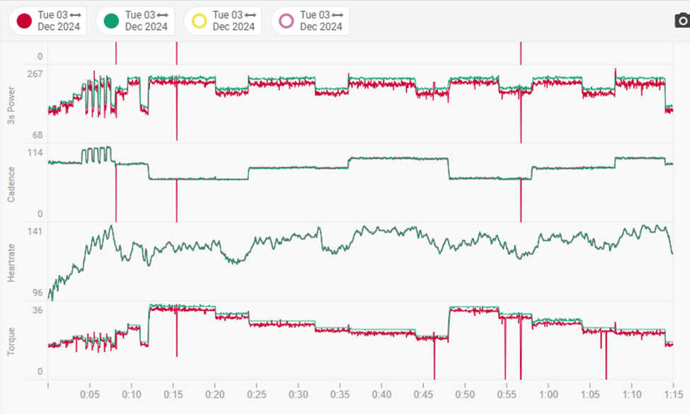

Wahoo gives higher values of aprox. 3-4%. The gap in absoulte numbers obviously gets bigger if I push bigger numbers.

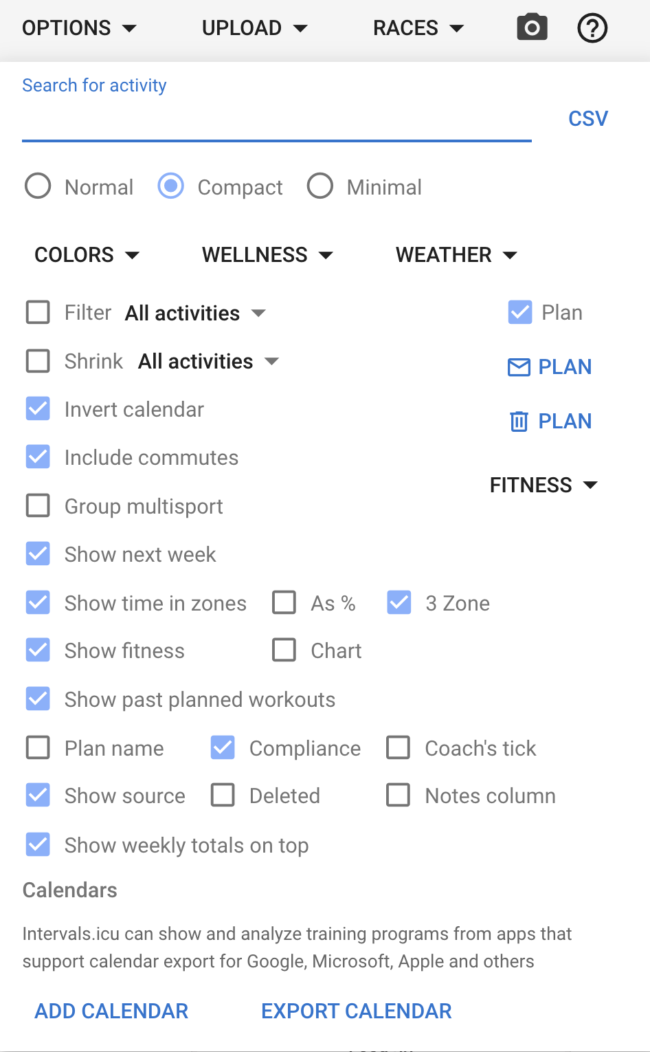

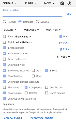

How do folks draw the comparisons above by the way? Intervals.icu’s de-duplication works too well, I rarely get both recordings of a workout to play with, and it’s also not always super obvious which one of the two it kept, then.
If its dual recorded and dual uploaded. One is deleted automatically (usually). you can tick the option → show deleted
