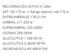

It would be very interesting to be able to configure the zones we want and not rely on something “standard”. For example, why work with zones at a percentage of submaximal values when with a power profile test and the ability to set the first threshold we can work with more “physiological” zones of the athlete? My system of zones is based on a base range of first threshold extracted with our system, where we get an optimal range by looking at the behavior of breathing parameters and hrv. Then we can draw zones from MMP 3 min, 5 min, 1 min, 15 seconds. This would be ideal to be able to set the zones to watt range just like you can do with heartrate.
Knowing that the zones are not prescriptive training, with this if they could be and combined with the heartrate would greatly adjust the external and internal load to the athlete and we would always work with very specific and personal zones, if in a race improves your p3 just have to change that value and or modify nothing else.

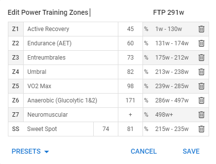

You have 9 “zones” showing, and currently the max number is 8.
It is possible to custom set ones, and rename them, but… they will remain Z1-7 + SS
I used your example to setup 8 zone (Z6 being from Glycolytic 1 to 2
I know it’s not exactly what you want, but it’s close (SS is used as a zone, and not overlapping)

Thanks @Gerald , I have it as you have put it, the idea was if it could be modified as for example Golden Cheetah that you can configure the zones you want, also it seemed interesting to me to be able to configure the zones also by watts as is done with heartrate.

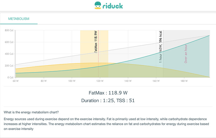

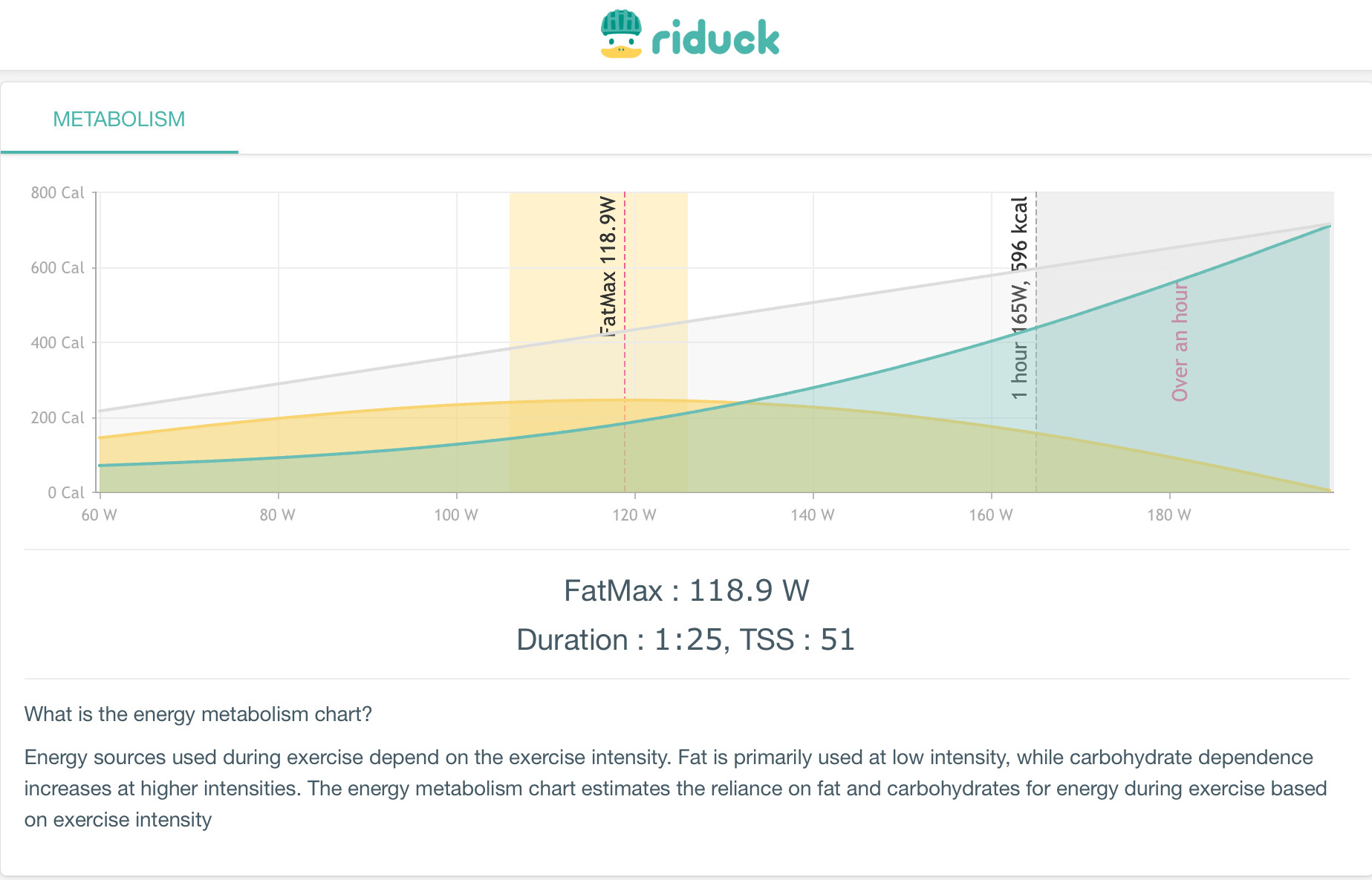

Still triggered by this chart provided by @RIDUCK .
Especially for Z1 rides, the (calculated) LT1 value is interesting. But also the LT2 value how it relates to your threshold values from testing.
Ps. The chart above isn’t up to date as I don’t upload data to Strava anymore :clown_face: @david would be nice to collaborate with @RIDUCK :slight_smile:

Nice!, would be a great addition to Intervals.icu :slight_smile:
Would like to put another plug in for a @RIDUCK integration with Intervals.icu. :slight_smile: I have found the zones and metabolism charts to be very close to what I get with my lactate testing and most recent lab test.
where is this chart? Had a quick search but couldn’t find it ni intervals as custom chart
There isn’t a chart in intervals, I was referring to the chart in @RIDUCK apologies for not making that clear.
