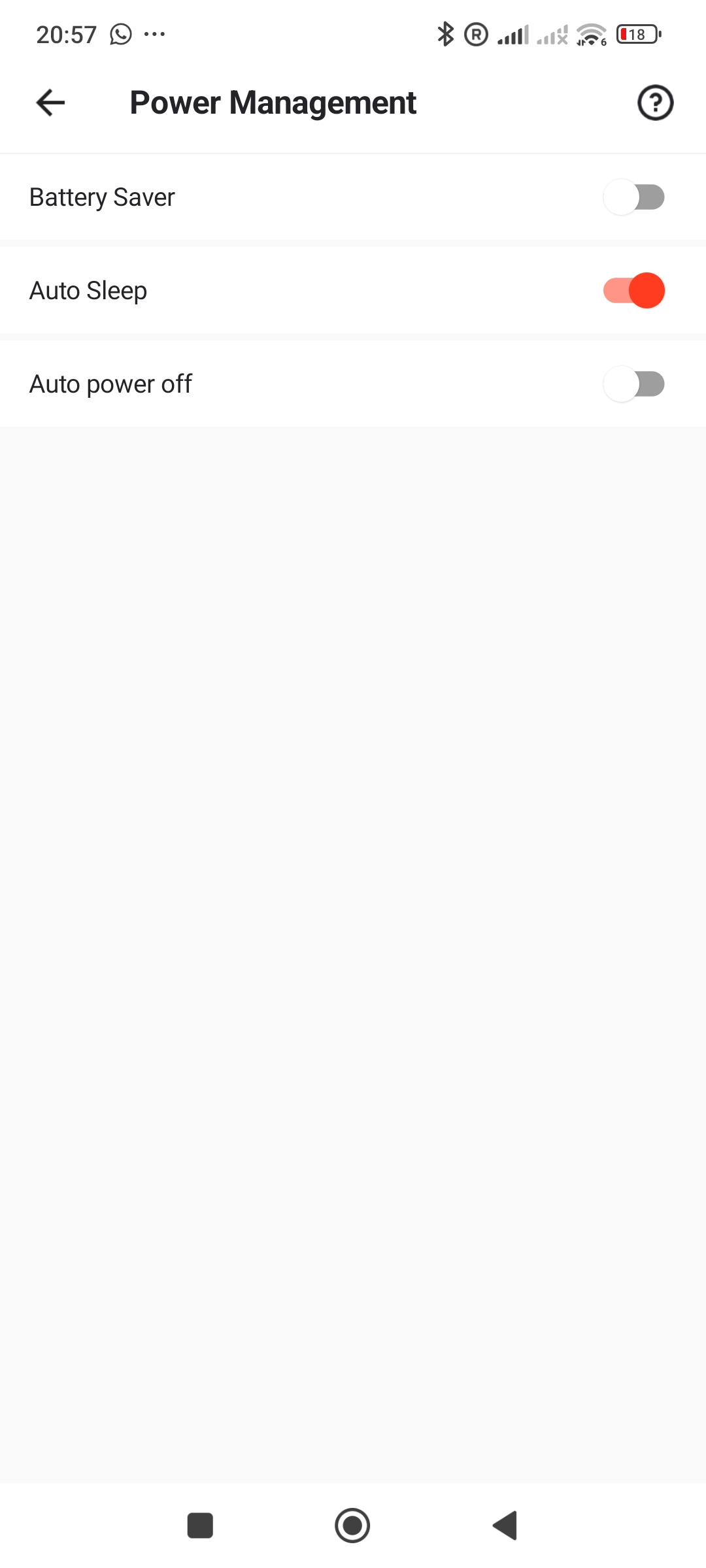

Battery saver mode is off

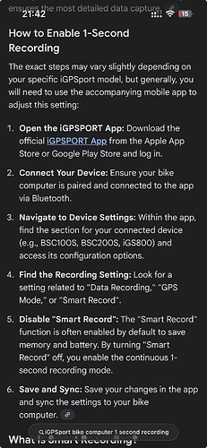

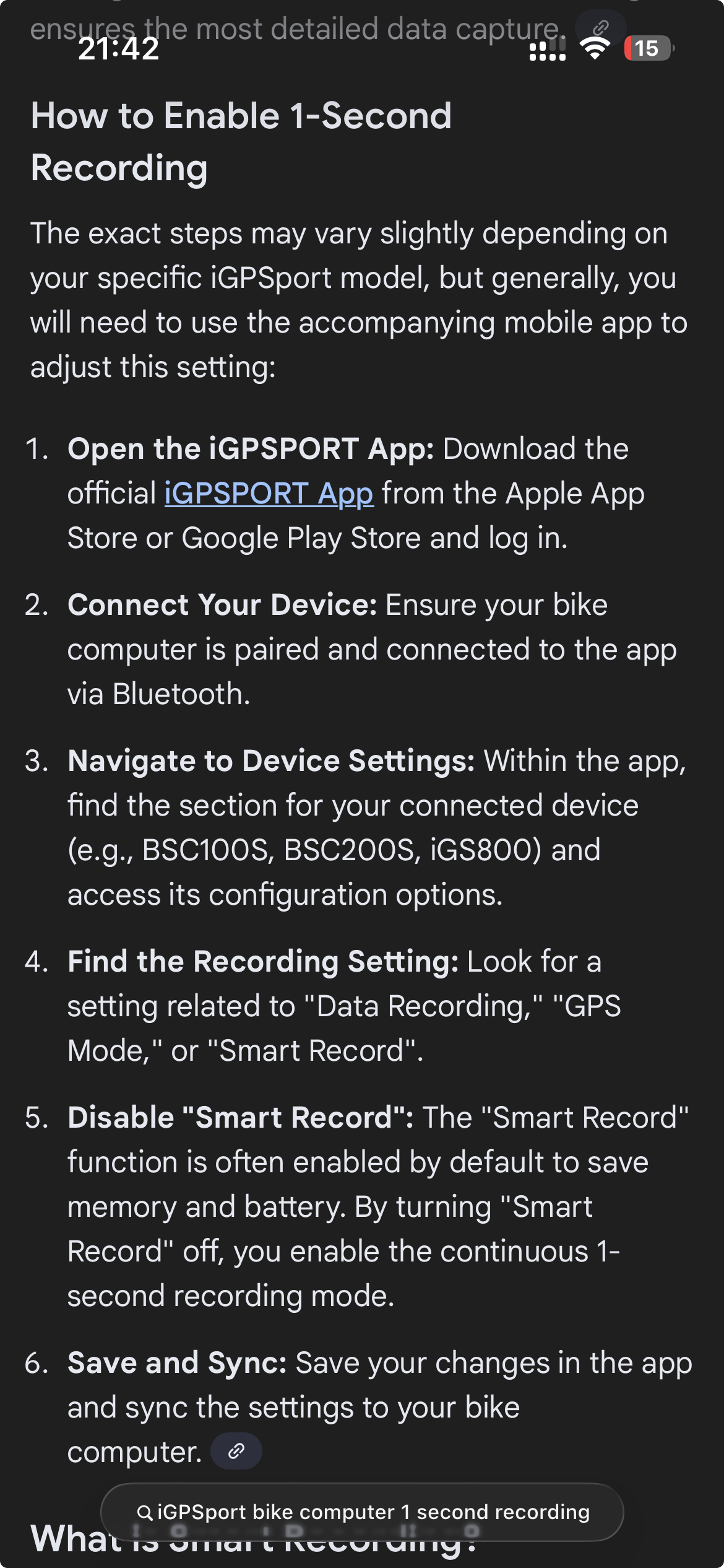

Google Gemini suggests the following:
Thank you for the fast reply!
I can’t find any smart recording or any comparable option

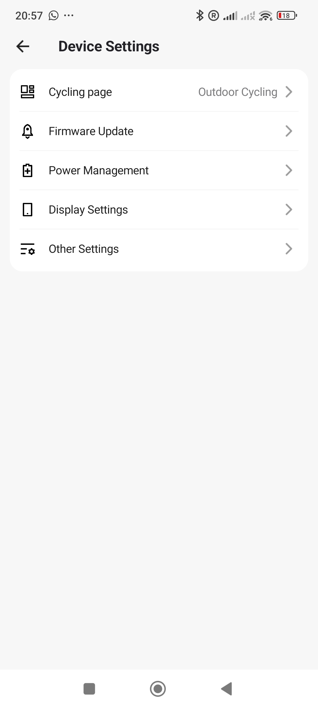

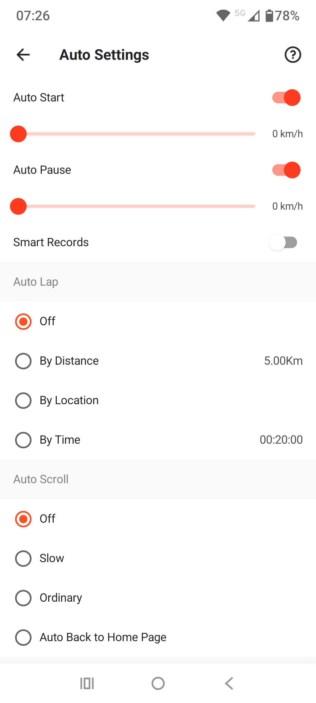

You will find it under “Cycling page” then “Auto Settings” → “Smart Records”
