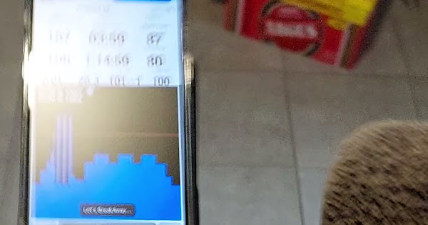

I’ll leave here 2 videos, which demonstrate the application working together with the Garmin Edge 830, to point out that all the attempts I made the application automatically crashes after 1 minute, crashes and jumps out.

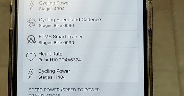

in all applications when using this bike we have to select only the left power sensor and the bike, in this case as seen in the movie it automatically turns on all sensors, I don’t know if it uses all of them but if so it causes problems,
I with several applications when trying to connect the 2 power meters always gave errors and did not work, until I realized that only the left power sensor is connected and it works well because it receives the information from the right sensor and sends both information to whatever it is switched on.

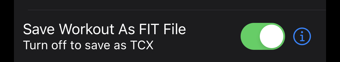

I can confirm that the Crash at the 1min mark is due to the LR power Balance that you’re seeing as 101- -1 (basically 101% L and -1% R). The app is continuously saving the FIT file every 1min (hence the crash at 1min) and the LR Balance is in error w/ a -ve number not being permitted.
I actually saw this from a crash report sent back to Apple so i have actually sort-of fixed that in the (not yet approved by Apple) BETA. [There’s a workaround for this crash, which is to turn off “Save as FIT” in the Settings/Advanced Options and this will save the output as TCX (which does not support LR bal)]

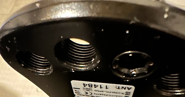

w/ regard to the left power sensor… how do you know which is L and which is R from the 2 sensors? (Since I don’t see any noticeable diff in the names)

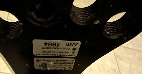

It’s easy, on both cranks the number is marked, in my case and as you can see in the movie are (4994 Left, 11484 right)
https://photos.app.goo.gl/1CmHXDSP6jkjYE3m6
https://photos.app.goo.gl/Pj2A7ZdoZHFqgUtc7
That I don’t know, I just know that in every application I tested I just turned on the cycling power and the left crank arm power meter, and it always worked great

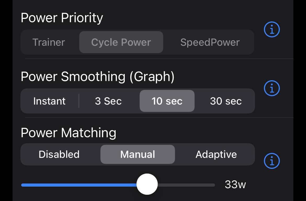

In the App, if Power Match is enabled, The app will default Power Priority to “Cycle Power” (meaning, it will display & write Cycle Power values to the FIT file and user will not be given a choice to select any other options)
This combo will cause the incorrect power being displayed (due to Right Power Meter Data)
However, if you disabled PowerMatch, Notice that the Power Priority options are now available and you can select to display the power from any of the sensors
In your case, The video w/ the power that looks OK, I believe you’re selected Trainer Power. The video w/ the power that looks BAD, it’s highly likely due to Cycle Power being selected.

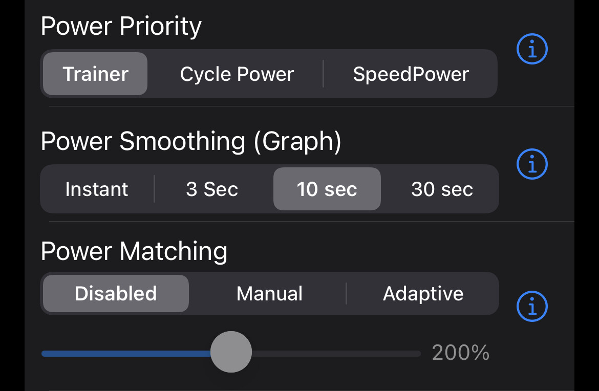

Test One:
  1. Power Match - Disabled
  2. Power Priority - Trainer
  3. Execute a workout
What I expect:
  • Displayed Power would be in-sync w/ the Garmin
  • LR Bal would still be problematic

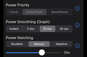

Test Two:
  2. Power Priority - Cycle Power
What I expect:
  • Displayed Power would have issues and be like 20-50% lower Than expected
Note: If you want to test beyond 60seconds, go to Advanced Options and disable this option. That should fix the crash at 60seconds. (i think you don’t even need to be pedaling, just start a workout and if the app is OK > 60s then that confirms it)

  3. No More Crash at 60seconds
    – with Save Workout as FIT File enabled
