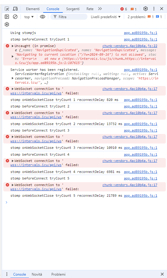

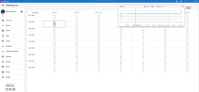

@david , as of today, on my PC I still can’t see my activities, this problem has been present since last Friday
Same problem whit chrome and edge.
Temporary files and history deleted but dont’ works…
If you need it
with my phone everything works fine
[image]
It looks like you are behind a proxy that is stripping out the WebSocket connection headers. Are you running some sort of ad blocker or antivirus proxy? If you are you need to configure it to allow WebSocket connections.
But if I click on my single activity from my file that downloads the name (.csv) of the individual activities , or I write the entire address ( Intervals.icu) , I see my activity.
Is it still an antivirus/blocking problem?
Thanks @david
Yes. Intervals.icu sends most activity, event and wellness data from the server to the app in the browser using WebSockets. If you open an individual activity and it doesn’t have it then it will make a normal HTTP request to the server to go get it. Thats why those are working.
