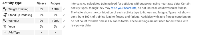

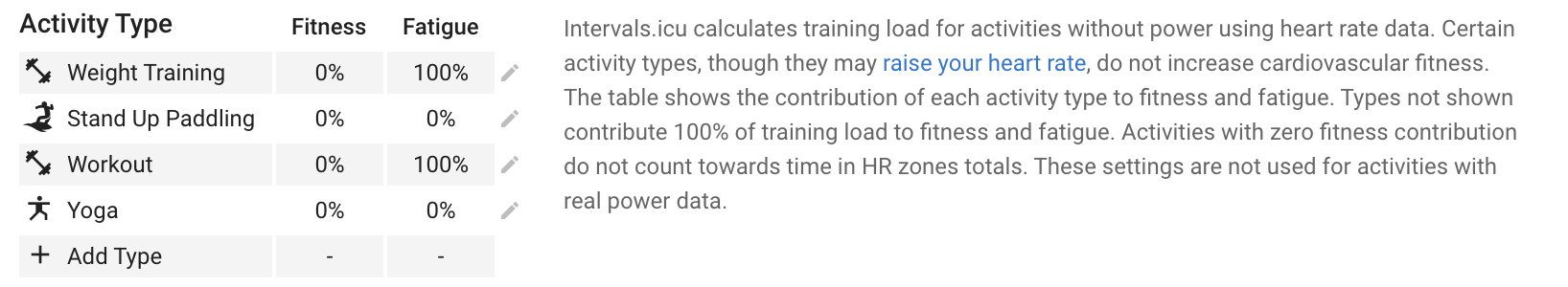

I tried to add TSS to a manual activity (yoga) which isn’t put until my fitness chart but when I manually add TSS for a different activity (snowboarding) it is incorporated. Am I doing something wrong or is this by design?
Some activities (like Yoga) don’t contributed to fitness or fatigue. You can control this behaviour in /settings:
How would I estimate load for a 90min weight training session that I’m entering manually?
From what I understand that wouldn’t contribute much to fitness (because its not cardio) but will create fatigue. Unfortunately I can’t help estimate either of those. No experience with weight training and how much it dings your legs.
