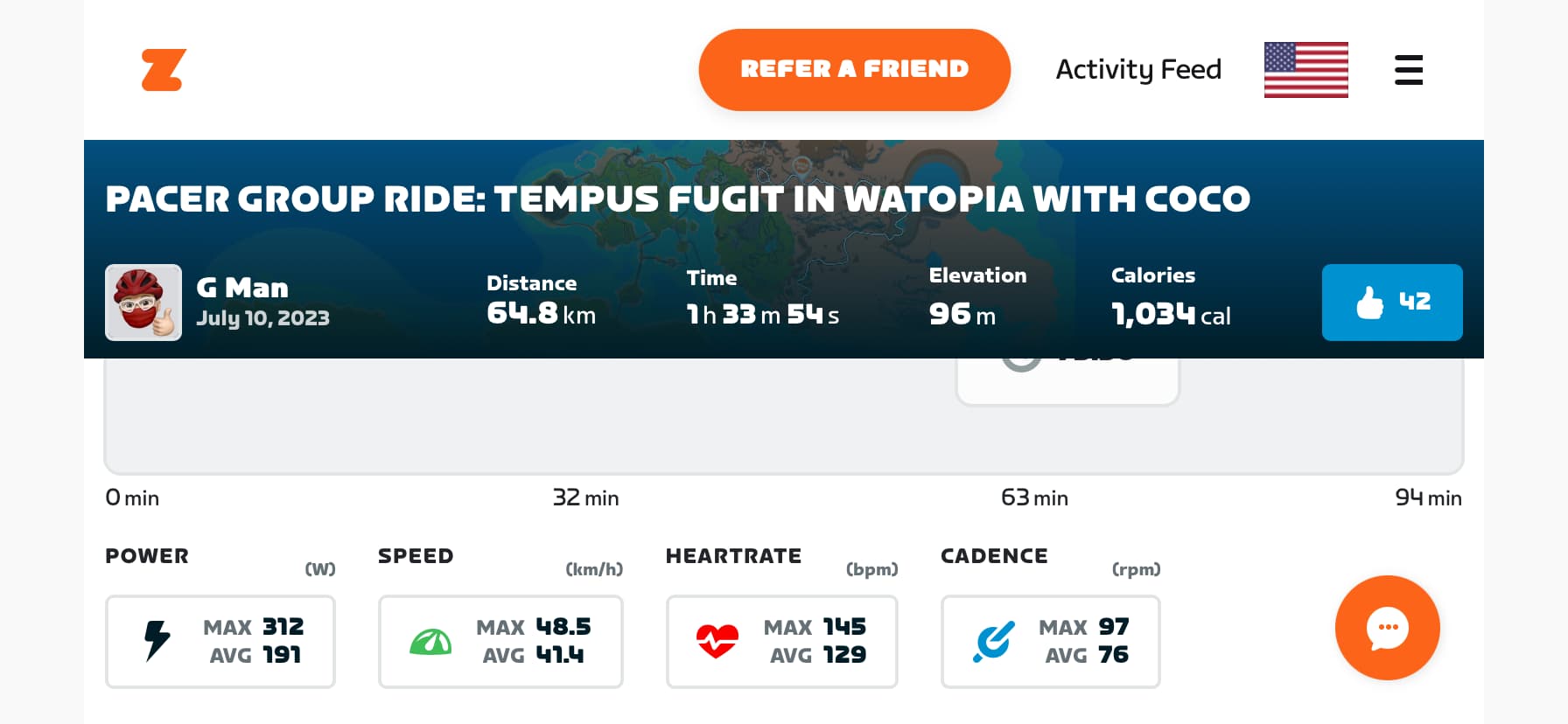

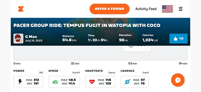

Where does one find load in Zwift?
I’ve looked at my rides and it only shows (Ave/Max) Power, HR, speed, cadence as well as calories, elevation and duration.

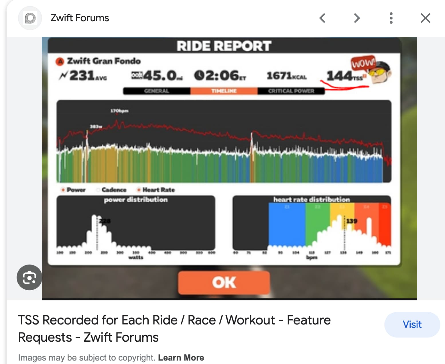

I remember that once you complete the ride, it’s there on the summary screen.
(Pic from Internet)
I’ll log in later and see if I can see it, in App. The website doesn’t show it.
Edit: I’ll be honest and admit I have never looked at that screen. Once done, I save and log out and head to TP and Intervals to complete my RPE.

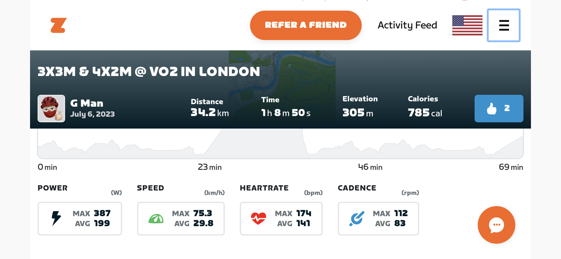

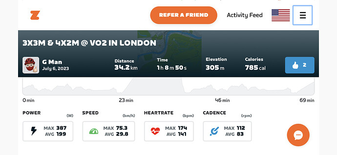

Based on the import from Zwift to Intervals for the VO2 workout I did (dual recording on Zwift and Garmin), both recording on a Kickr Core (Zwift uses the FE-C profile through BLE and Garmin used the Ant+ profile):
  • Ave. power: 199 (Garmin) vs 198 (Intervals);
  • Load: 87.3 (Garmin) vs 86 (Intervals);
  • Duration: 1:09:06 (Garmin) vs 1:09:07 (Intervals);
  • Normalised Power: 229W (Garmin) vs 227 (Intervals);
  • Heart Rate: identical average and Max
  • Coasting Time: 0s (Garmin) vs 12s (Intervals). The raw power in Intervals shows a drop in power, probably when changing front chain ring in a recovery interval.
Typically for an Indoor Ride, the numbers differ by 1-5 or so and I just don’t bother with them.
