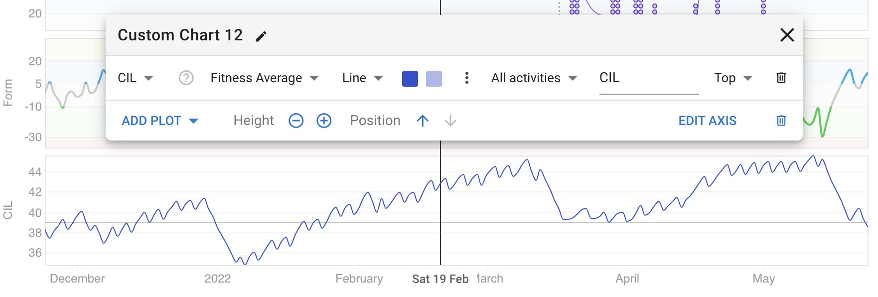

You can’t do that currently but looking at CIL (chronic intensity load) will do something similar.
Chronic intensity load (CIL) is a 42 day exponentially weighted moving average of the intensity for each activity. It is similar to fitness but removes the weighting for duration. It is a useful measure to look at when you are trying to reduce volume and maintain or increase intensity - Chronic Intensity Load
You can add a custom chart on the /fitness page:
