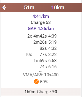

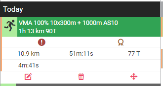

Some year ago i move from Training Peaks to Today’s plan… I have also diffrence in the load computed on run (from pace). Today’s plan was bigger…
Now i am moving to intervals.icu, that is really really great.
And, now the load is smaller…
I am using pace to compute the load.

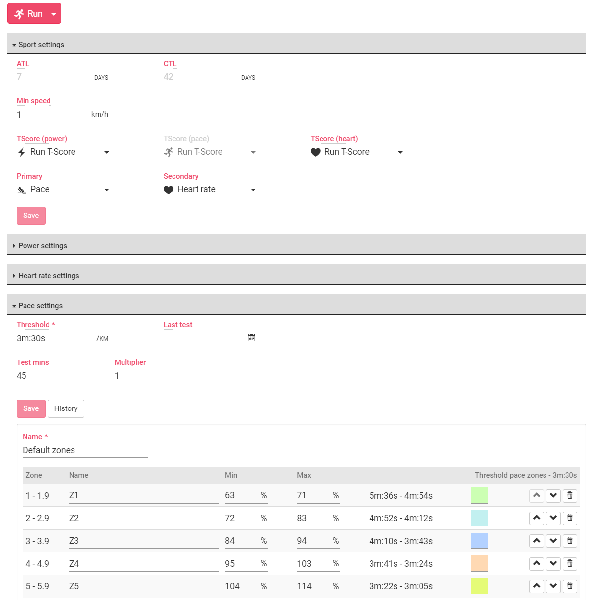

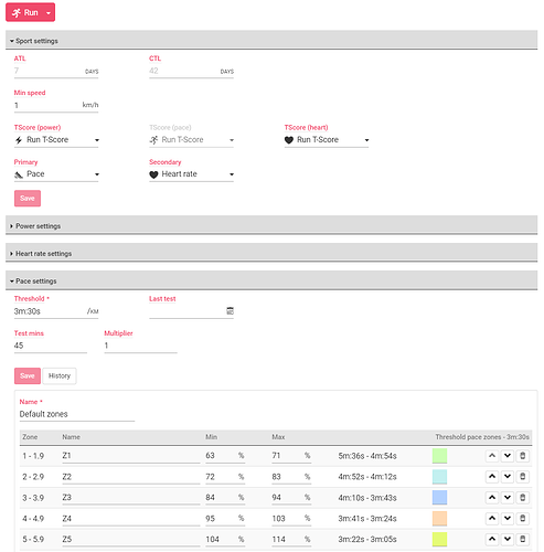

For the same workout, i have a result of 77 TSS on today’s plan and 53 on intervals icu. I have the same speed in my setting for the “seuil” : 4min/km.
Intervals.icu has a new run load calculation in the works that might produce a number closer to Today’s Plan. The current number is supposed to be close to TrainingPeaks but doesn’t count stopped time.
