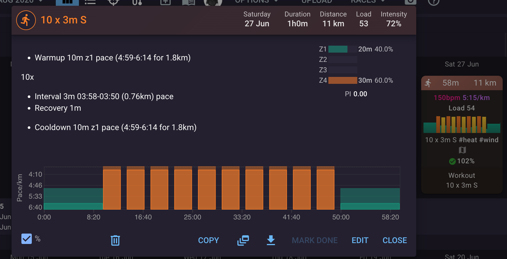

I don’t know how to check which part has a different load. I just noticed something weird. This is the workout in my library with a load of 53 which is what I would expect:

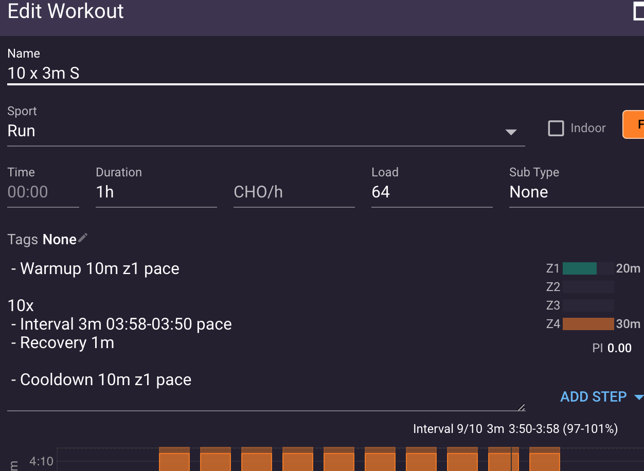

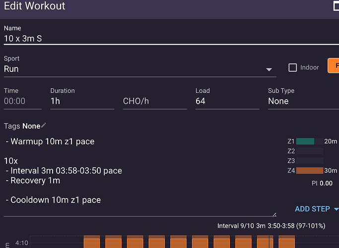

And this is the exact same workout when I go to edit it, now showing a load of 64:
What is going on here?

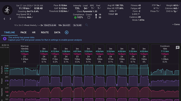

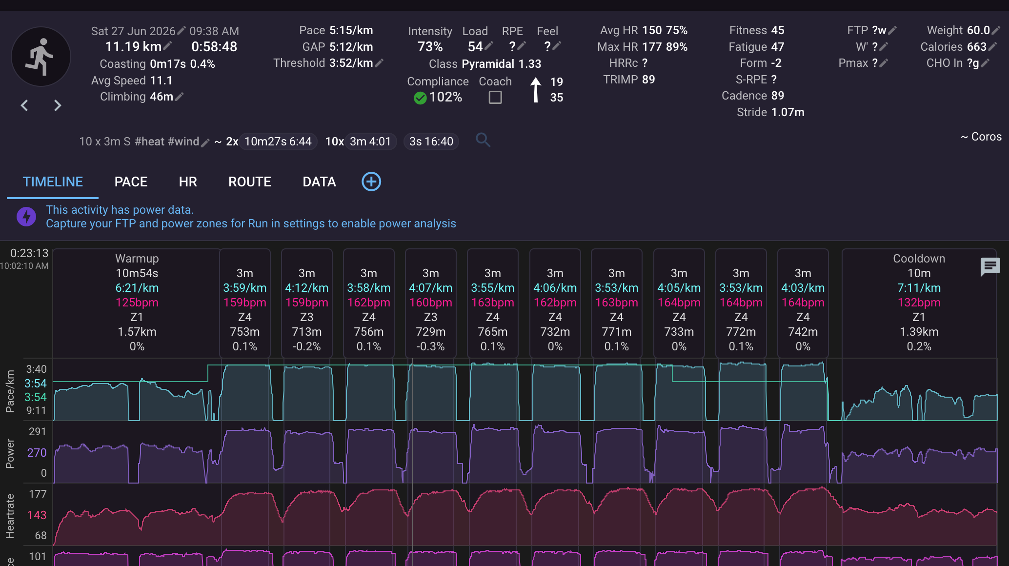

Did you do the workout before? Do you have an older entry on the calendar of that workout? Can you show screenshots of the workout (without clicking edit) where the load is different?
Yes, I have done it before but not for a few weeks due to an injury. This is the last time I did it from my calendar:
I think you did overwrite the load value manually (this might has changed that the load value is now recalculated more often, for example by dragging and dropping to the calendar - I think there was a bug somewhere).
Your recovery has no target value, so that calculation might have changed recently too, but I am not aware of.
I would suggest to always use targets, you could come close to your load calculation of ~53 with a target of 1% pace like:
