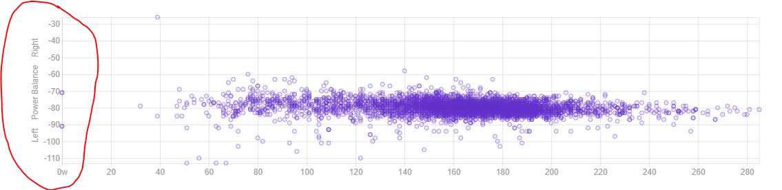

It worked well for a while, but for my last two rides is giving me 180/-80
idk what to do. kindly help.

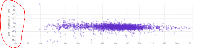

Tx. I just fixed a bug in the fit importer that was causing this. I fixed your ride on the 7th of Feb. If you have others that are broken click the “Garmin Connect Sync” button and that should sort them out.
