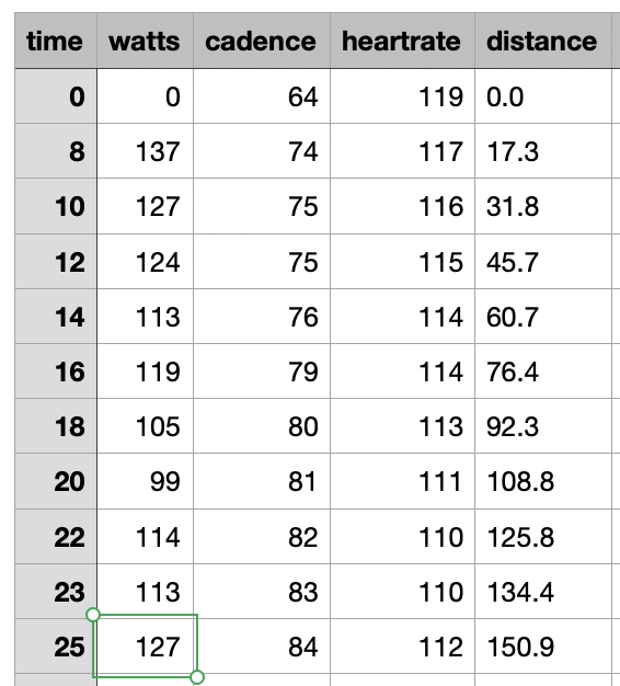

View the fit file second by second in intervals.icu and post a screenshot of the time and the power, I’m curious and I will get this to the right person on the Garmin 1040 team if necessary.

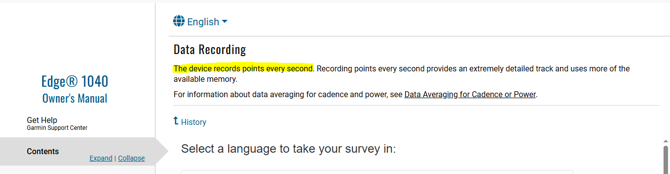

The 1040 automatically does 1s recording. You cannot force the device to do smart recording, it never had this option. This is why you won’t see a 1s recording option. 1s recording is just what it always does and always has done.

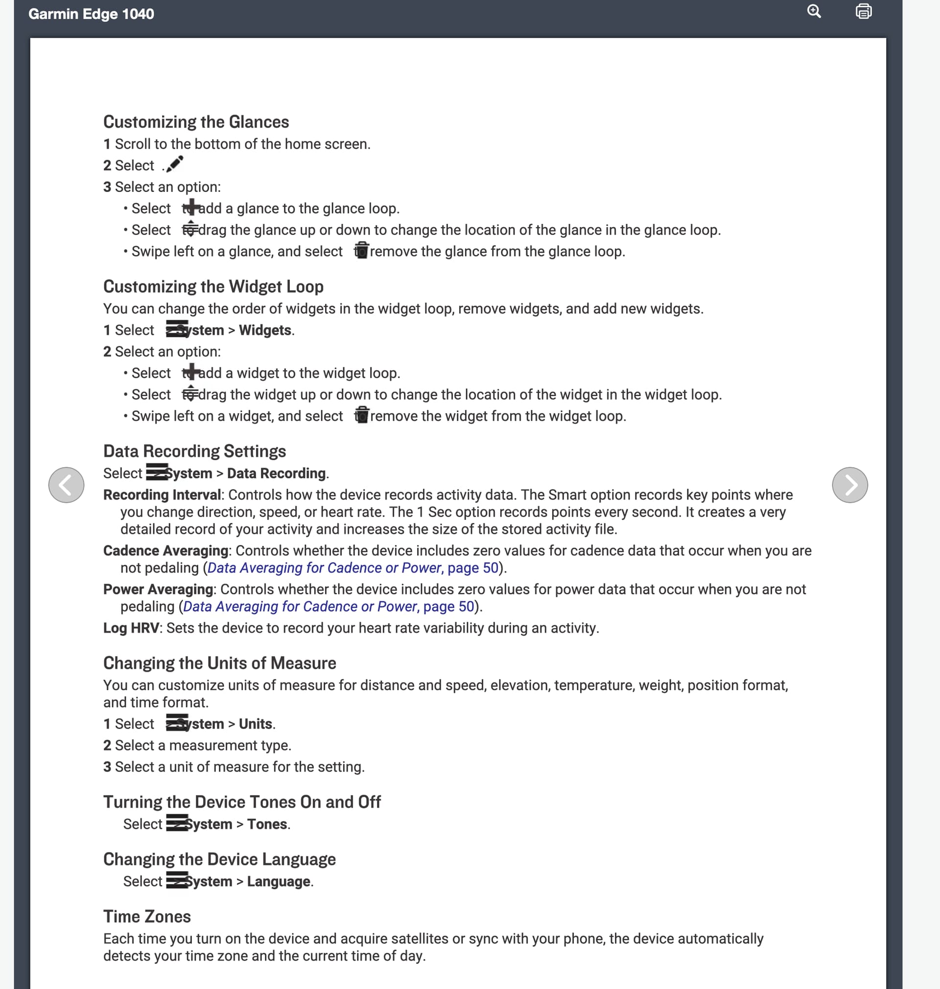

You are wrong. 1040 had an option to use 1s or smart recording but it was changed with a 15.23 release, and after that moved to 1s only, but originally there was the option to change the recording intervall. Garmin states in the manuals that all other edges has such an option but not 1040 for whatever reason. Knowing their mess…they either were merging changes for all older edge devices and implemented that to 1040 forgetting to add the switch or they partly updated the osftware for 1040 with the bits from older (pre 15.23) software.
Oh and btw. that change of removing the switch and removing the smart recording was considered a bug bc it was not mentioned anywhere in the release info…bc garmin is amazing and not bother about such things like changelogs and it was the only edge device pushed to 1s only recording (all other are supporting smart recording per their own manuals). So I can argue that they just had fixed the long (3 years old) forgotten bug, but were not smart enough to implement a button, GArmin do such stupidity all the time. Again what is your solution to OPs problem?
@MedTechCD
original manual:

That’s why I want to see the numbers from the fit file, for all we know it’s doing 1s recording perfectly and it’s some issue on the intervals.icu side

fitfiletools also confirmed that the original source .fit file had all the data every second and there was not smart recording there.

Your ride has come to Intervals.icu via Strava. If you download the “Streams CSV” on the activity data page you can see that it doesn’t have every second recording.
You need to download the original fit file from Strava and look at it on fitifileviewer.com to see if Wahoo or Strava is doing this.
