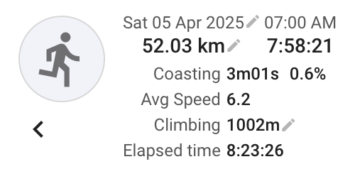

Garmin recorded 32.33 miles, 8:23:25 and 5,269 ft ascent.
The timeline data that copied into Intervals reports 32.33 miles, 7:58:21, and 3,287 ft climbing.

Intervals.icu uses moving time in most places whereas Garmin is reporting elapsed time. If you look at the time on the timeline chart it goes out past 8 hours.
I have an outstanding todo list item to “use elapsed time for moving time” on a per activity and per sport basis.
If you edit the layout (new feature, do Actions → Edit Summary) you can add elapsed time:

Ok great, thanks! I wondered if it was something to do with the moving time vs elapsed time.
What about the difference in climbing elevation? Should I just edit that number on the timeline?
I think I found the issue. I had “use elevation correction” checked under the timeline settings. When I un-checked that option, the climbing number changed to what Garmin had recorded.
