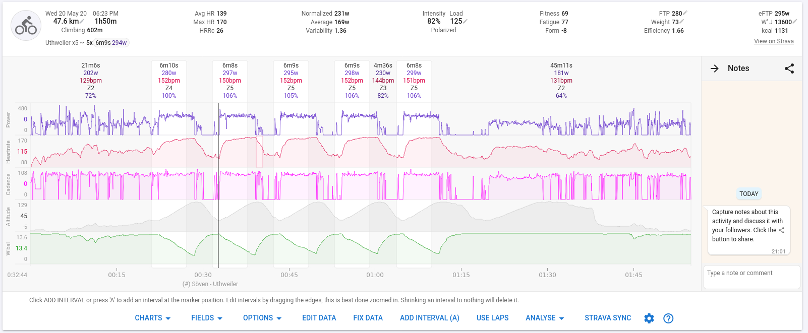

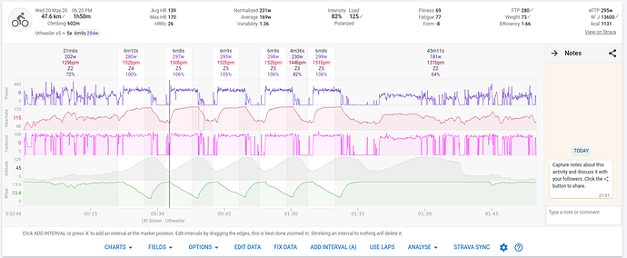

I recorded an outdoor interval session where I used the lap button to mark my intervals. In the activity I clicked “use laps”. The laps displayed seem to be shifted by 1 minute (beginning earlier) compared to when I pressed the button.
The acitivity: Intervals.icu
The same can be seen on other activities:
Recording unit: Garmin 810
