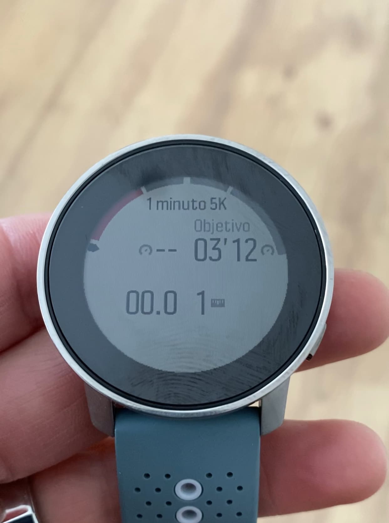

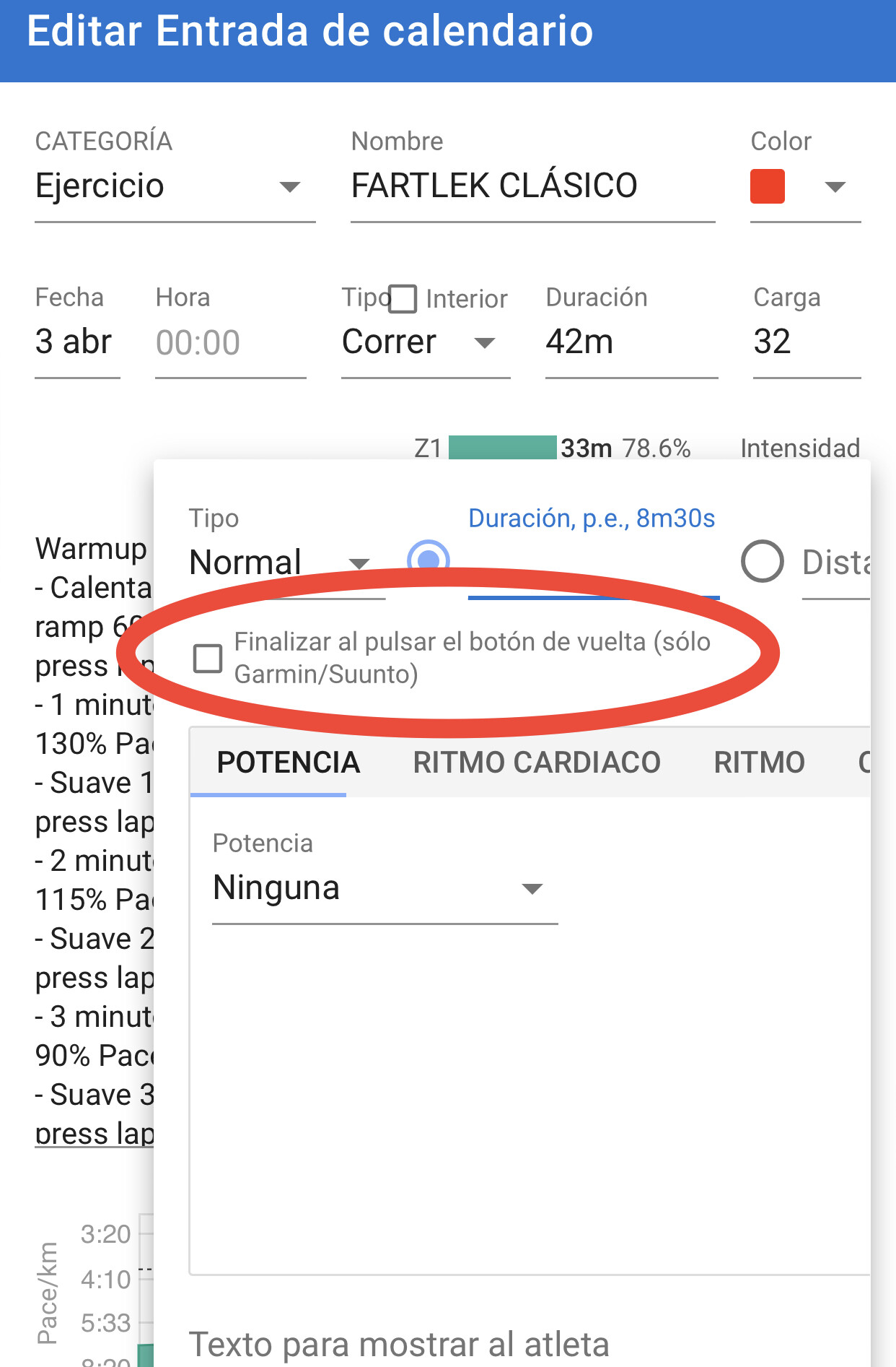

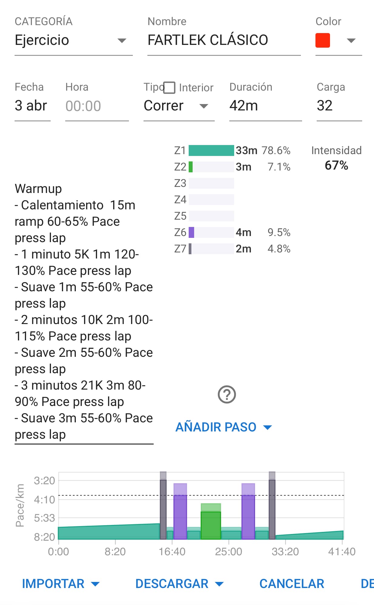

Issue with the lap button to end step, when I select this option the step does not end automatically when the countdown reaches 0, it should end automatically since the option to end step with the manual lap button is not to change the step, it is to end a step early.
@david I think we should change this to work similar to TP :blush: thanks!

I have updated the Suunto workouts to end the step when the lap button is pressed or the duration/distance is reached. Hopefully that does the job. Will deploy Tues AM (GMT+2).
