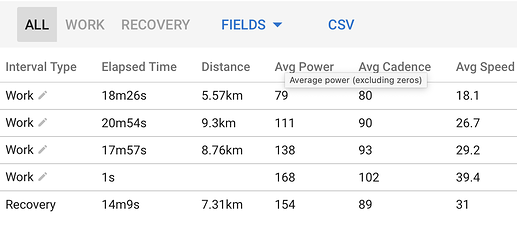

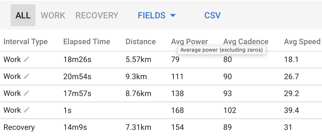

I was looking at my own ride this morning.
Garmin → Strava → intervals
For Intervals. I am using “Actions → Use Laps → Analyse → Keep All Laps”. The Garmin is configured to auto-lap at 10km. Data from intervals is not consistent w/ the expected data.

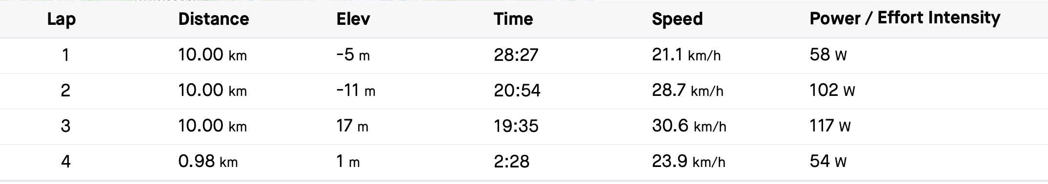

Laps as seen from Strava

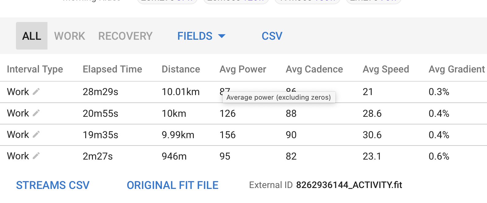

So… i got curious…
I downloaded the original FIT file from Garmin Connect and manually uploaded it into intervals.
It worked well.
