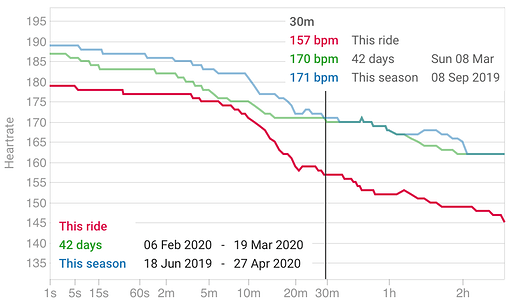

You can get that from the activity HR page from any activity with HR data from the HR duration curve:
Forgot that, which is already taking more than just one effort into the mix. Still, I fail to see the usefulness of it, and from the OP’s initial LTR question you should move the slider to 1 hour, but then again, we all have our own needs :sunglasses:
So, as you can see, the LTR HR range falls nicely into what the curve shows…

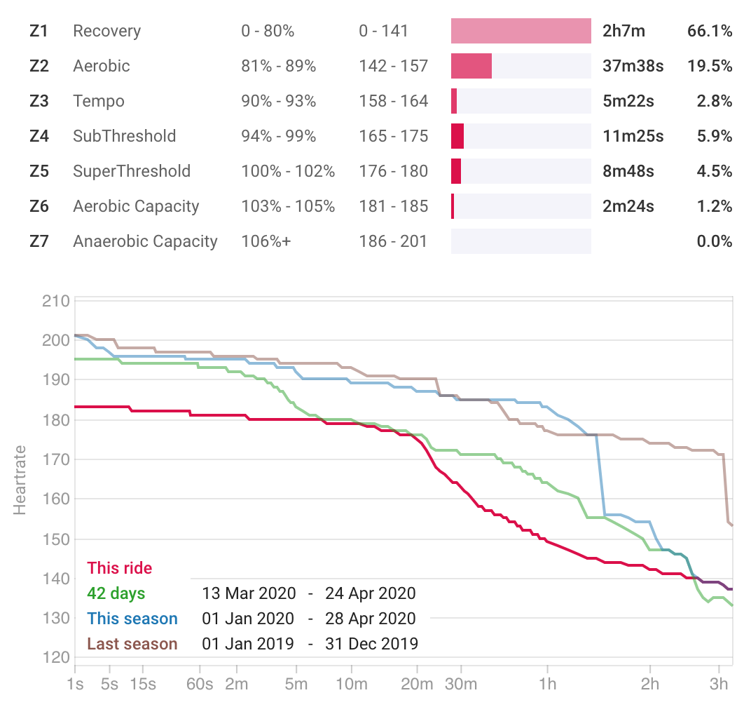

Does not work as well if you run too:
My cycling LTHR is 175 and running LTHR is 182. But it is quite possible to go above those in the race conditions.
