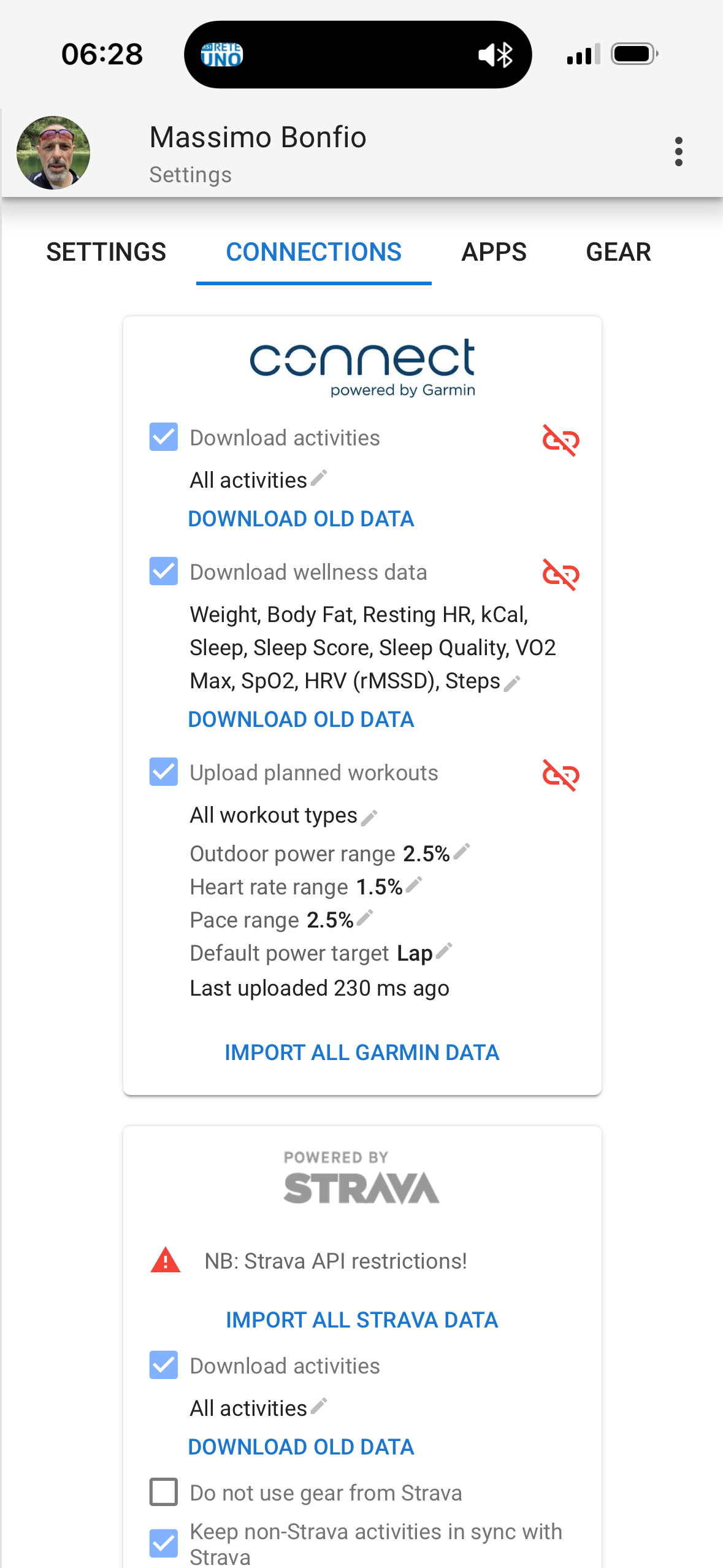

I have this in the Garmin connection. Does it mean there are connection issues?
No, the red icon is a ‘disconnect’ action.
Everything looks up and running.

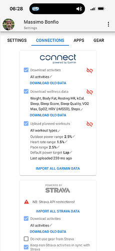

I have tried to check the planned workout checkbox in the intervals.icu connection menu but it did not resolve the issue.
I did not change anything in Garmin besides trying to reinitiate the connection to intervals.icu.

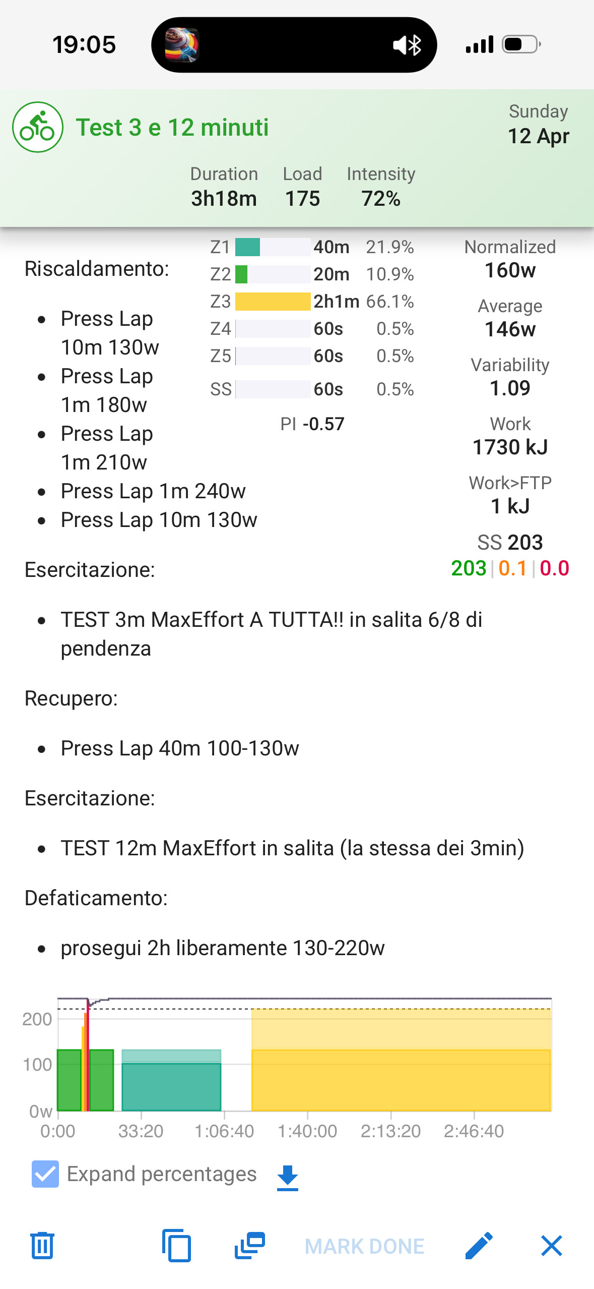

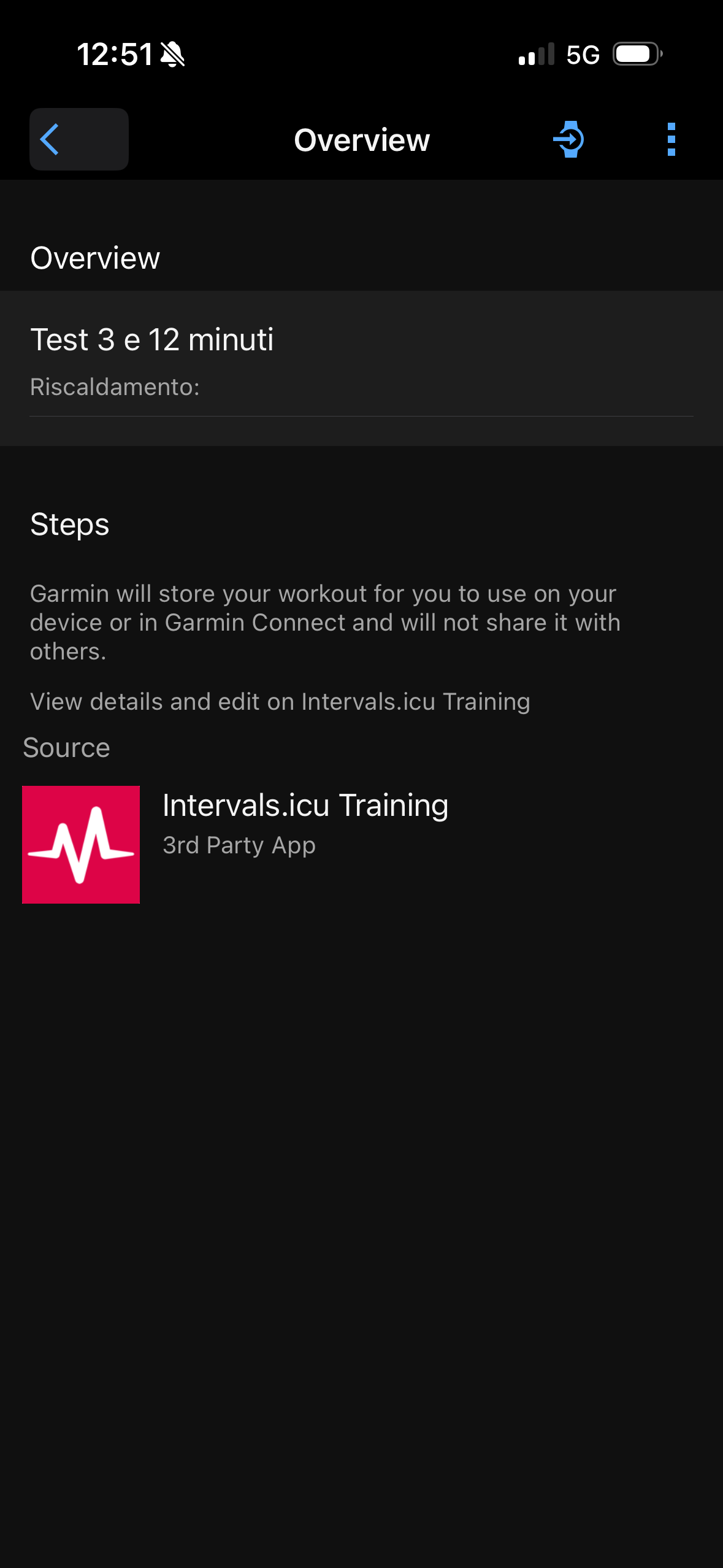

Ho, I didn’t explain correctly. I get workouts from my coach on Intervals, I see them in the Harmin Connect app on my iPhone, but they don’t sync to the Edge 1040 I see the following in the Connect app:
If I tap on it I don’t get the breakdown in steps and get nothing on my edge.
Everything is updated to the latest version.
I saw on other post from someone with a similar issue, with workouts not syncing since April 8
You will not see details in Garmin Connect, that’s a limitation introduced recently by Garmin…
But, if the workout syntax is correct in Intervals and you sync to the Edge, it will work.
Can you show the wotkout steps as they are in Intervals?

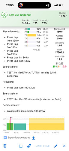

I hope this will suffice, it’s a print screen of my phone.

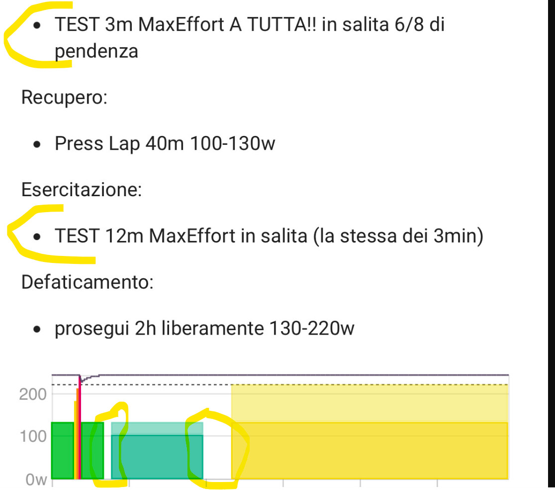

I think it is enough to explain what’s wrong
The steps highlighted have no target.
I guess Garmin expects some kind of target, be it HR, Power, Pace.
