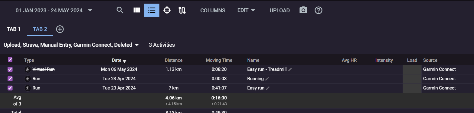

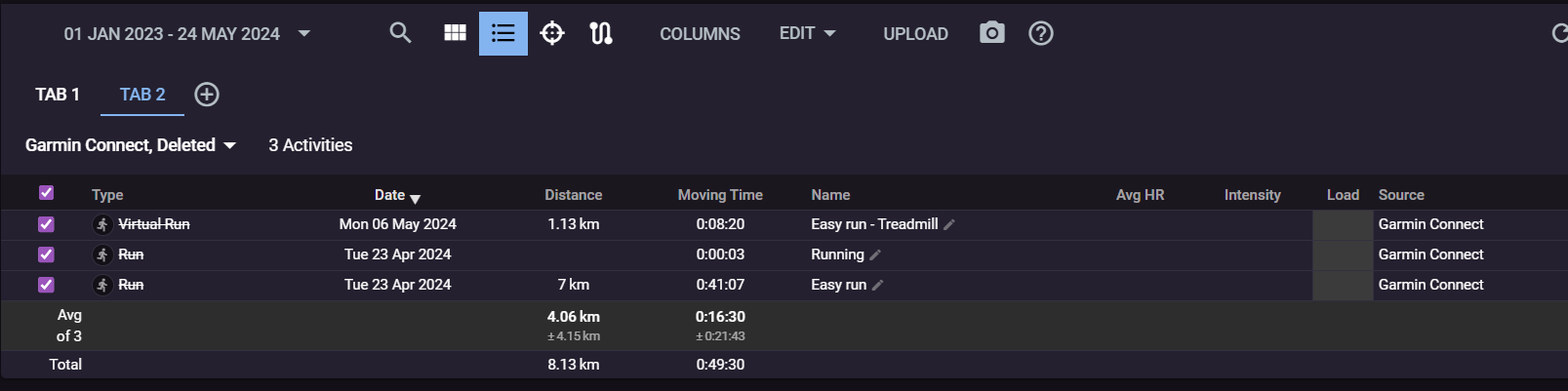

I deleted ~1000 activities from 2023-2024 and I can’t find them under “deleted”. That’s my main issue now.
Change the filter to only Deleted and Garmin Connect
Same thing.
