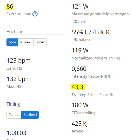

Intervals is under estimating the load. Garmin & strava & xert tell me around 170 but intervals calculates 90? is it due to the short duration of the intervals maybe?
everytime I do this kind of workout I get undervalue load
thank you

I think Intervals.icu has it right. 90 TSS for a 1h05m workout is a lot. If that was 170 it would mean your FTP was set way too low. TSS is normalised so that a 1h effort at FTP is 100 TSS.
The normalized power is 253w which is the same as reported by Strava Sauce and that is what is used to calculate the load.
  1. Do you have FTP set correctly on all platforms?
  2. Are you looking specifically at TSS or are you comparing to some proprietary number? Garmin for example has TSS but also Exercise Load.

Exercise Load and EPOC
After you complete a workout, your body continues to use oxygen at a higher rate than it would at rest (the “afterburn” effect). This phenomenon is known as excess post-exercise oxygen consumption, or EPOC. Since the oxygen your body consumes relates directly to the amount of energy it uses, EPOC is an excellent measure of Exercise Load. It quantifies how much work your body has to do to get back to normal.
It’s part of the Firstbeat analysis parameters, so you only have it on units with those metrics.
I have a Fenix 5x+ so that is w/ FirstBeat for sure, however, Garmin (even tho they now own FirstBeat) they don’t backport the new stuffs into their old stuffs.
