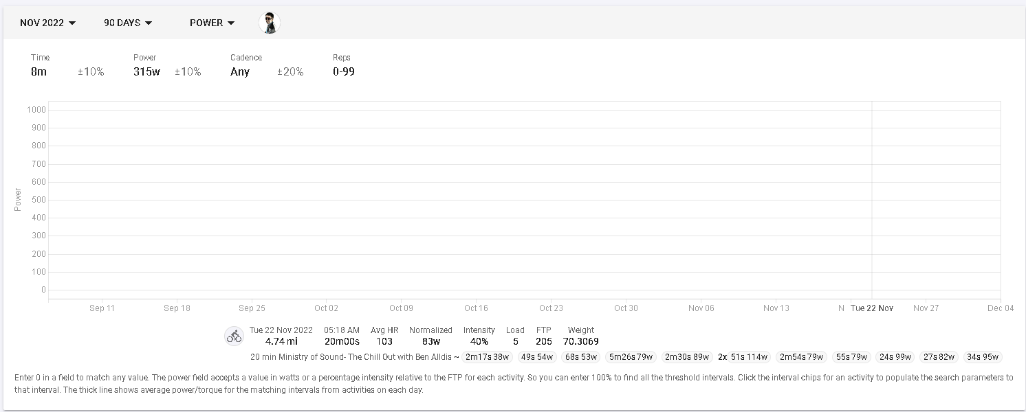

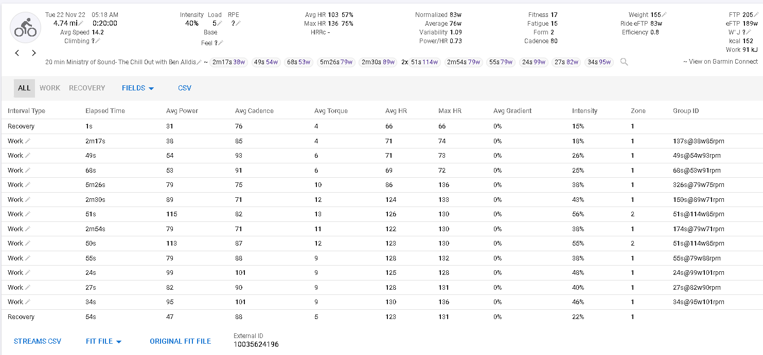

I followed the instructions above and using laps and re-analyzing the data. It appears that my workouts have interval data, but the Intervals tab still appears blank (although it does look like at the bottom there are workouts being recognized). Below is a workout from November. Maybe I’m missing something else?
Hi, just bumping this. My intervals tab is still showing up blank, but as noted in the picture above, it does look like the data is being identified.
Any suggestions? Appreciate your help!
Your search criteria are:
  • 8m +/- 10% or 7m12 to 8m48s
  • 315W +/- 10% or 283W to 346W
I can’t see any interval in that workout that meets both of these criteria…
Ah, I see now. I didn’t realize I could update those fields. My mistake. Thank you for your help!
