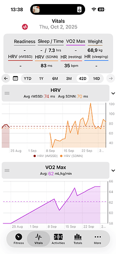

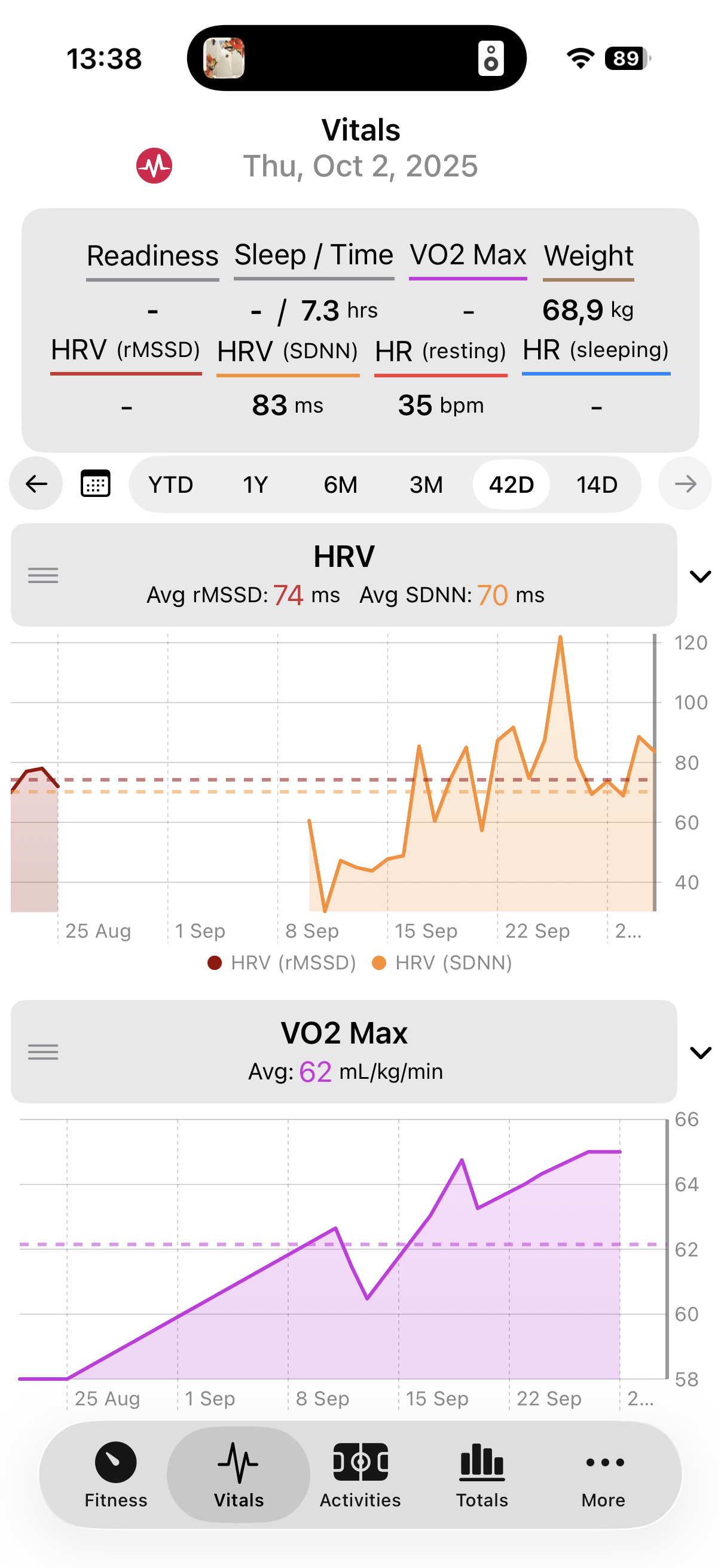

Hi. I do not find anywhere to tell your app, or in the connection with healthfit, to get vo2max from apple health. Is this not possible?

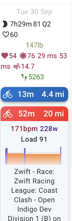

The app reads the vo2 max from the intervals api, so you will need to get it synced there first. I use the HealthFit app to automatically sync my Apple Watch/Apple Health metrics to intervals. Once that’s set up you will see the metrics at the top of the calendar days like this:
I also use HealthFit to sync wellness data, but the VO2Max datafield in the companion app does not show up (I do not see it in intervals.icu either). Is there somewhere specific I need to tell intervals.icu to get this data point from HealthFit?
I stand corrected… Vo2Max is in intervals.icu, but not in companion app.I also miss sleep score? There is a field at the top of Vitals screen that says “Sleep/Time”. Time is there, but the “Sleep” field is missing… I am guessing this should be some kind of score? Also the HRV (rmssd) is empty, where should this be pulled from? My HRV4Training app?
Unless ofcourse, the top section only shows todays data… then it makes sense.
The app will only know about data that you send to intervals, so readiness and sleep scores, hrv rmssd, etc, all need to be sent to intervals in some way first. Oura, Whoop, and maybe Garmin can sync these with intervals. Apple Watch only calculates the HRV SDNN value. The app doesn’t calculate anything on its own, it just reads the fields from the intervals data api.
The top section shows your current selection on the charts. I’ve noticed with my Oura ring, if I sync my ring to the Oura app, then load the intervals website it will trigger the data to be pulled in from my Oura account. If I don’t happen to load the intervals website, at some point during the day it will automatically sync and then become available in the iOS app. So what you see with the current day not showing values is normal, it just means you don’t have a value for that day yet, or that HealthFit hasn’t synced yet.
