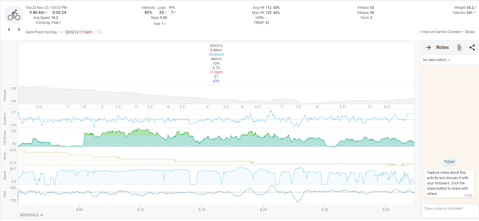

Intensity seems too high for activities without power
All my commute rides are above 80% intensity.
Find below an example recorded with device Garmin Fenix 6:

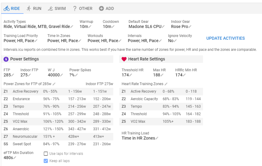

Find below my HR settings:

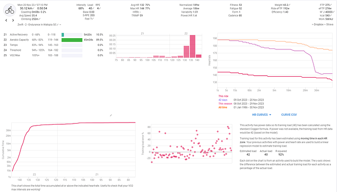

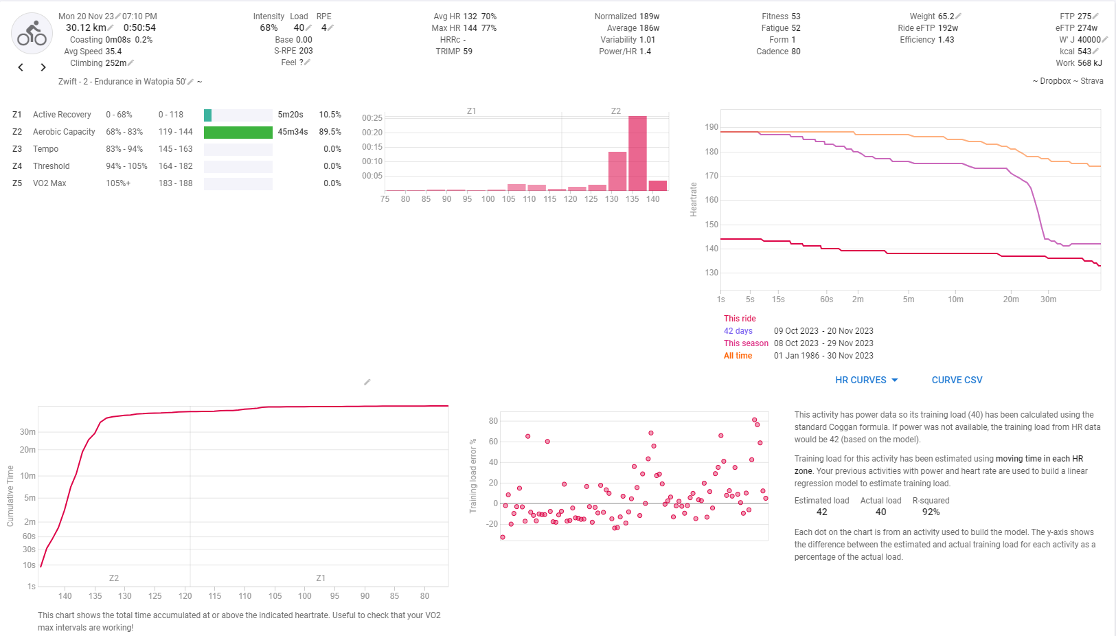

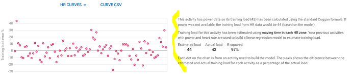

Here an example of a Zwift Z2 50’ ride with 68% intensity (which seems correct from my perspective):
Can you show a similar screenshot from one of your commutes? The reason I’m asking, is that HR on your commute, at least the one above, is significantly lower. And maybe the model doesn’t have data for the lower HR region?
In the Zwift screenshot above, you can clearly see that the model is working well for HR that is a bit higher. 42 versus 40 is a very good estimation.

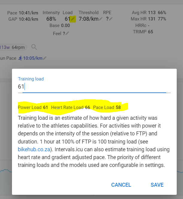

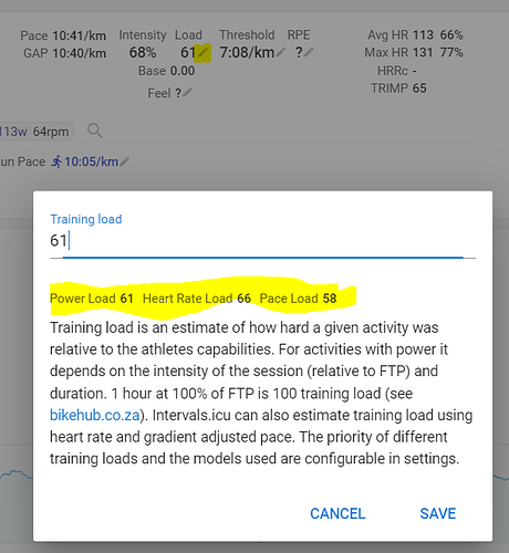

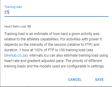

And also click on the pencil icon next to the Load metric in the summary, to make sure that load is derived from HR. It almost certainly is, but just to be 100% sure. Example from one of my runs:

Training load on the commute ride:

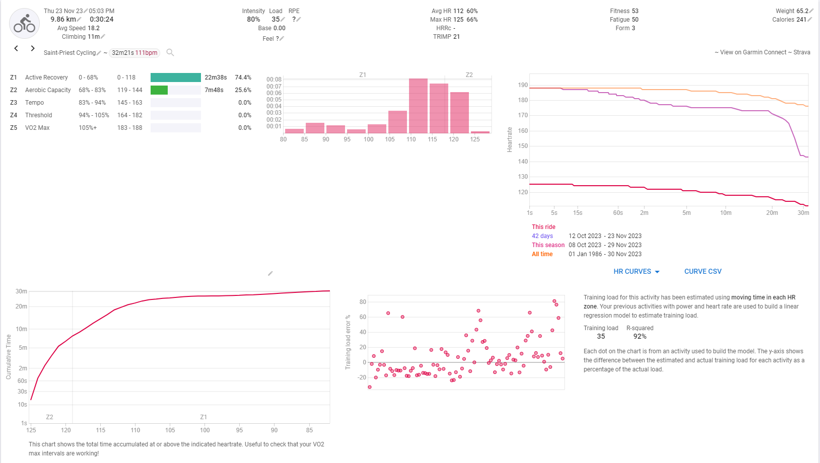

Activity HR of cummute ride:
@david Would you have time to have a closer look ?
Many thanks
Finally figured out the reason:
I had my HR Training Load set to “Time in HR Zones”. Looks like this model is not working well for low intensity rides.
I have changed to HRSS and now my training load for commutes is between 5 to 15 which seems appropriate.
