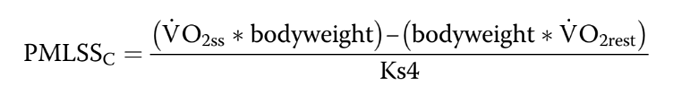

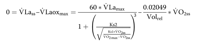

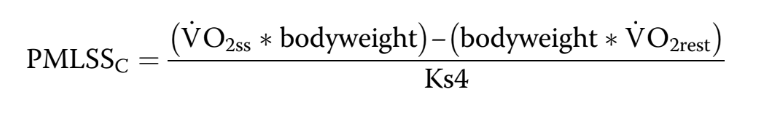

You probably have read Hauser’s paper (Comparison of calculated and experimental power in maximal lactate-steady state during cycling - PMC). You can find how to do it there…
  1. You need a decent estimation of your MLSS. With that you can find VO2ss.
  1. Then you need a decent estimation of VO2max. With that you can find VLamax with the formula below.
At least that is how I do it for myself. And it works well enough to help me on my training.
Oh yeah, I like Hauser’s paper. They break the 1986 Mader work down nicely.
Back calculating VLaMax from the rest of the model is ok if the other parameters are known, but estimating VLaMax off of both VO2Max and mlss estimates is too messy for me. At that point, just use CP testing and be done with it.
