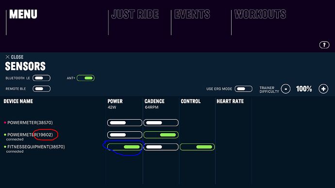

If you have something like RGT cycling, it’s very easy to demonstrate power comes from Assioma - connect your Garmin to the Assioma (circled in red) as the power source, Connect the Trainer as the power source in the app you use (RGT), circled in blue. Then run a workout or ERG session, recording on Garmin and RGT / Zwift etc at the same time, compare files and you can see this quite clearly the Garmin .FIT will report the power from the Assioma, not the trainer because they do not match identically (2 to 3w average and trend difference with a v4 in my case)

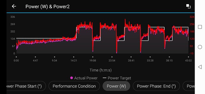

Anyway this should be self explanatory. Power is from Assoima. Power2 is from Wahoo Kickr v4. When they match so closely as mine do, to a large extent the discussion is a moot point as the differences are within the accuracy levels of both meters.
