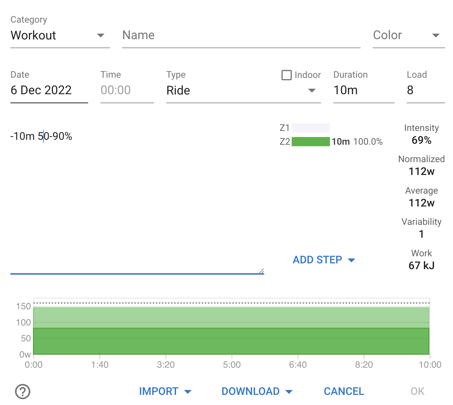

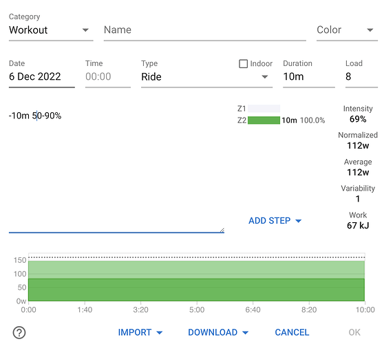

when workouts are created, you have the option to specify the range of power eg: 50-90% (exaggerated for visual clarity)
IIRC, When this workout is sent to Garmin, Intervals will send the average power to garmin, but it will also show up as a range for you to hit.

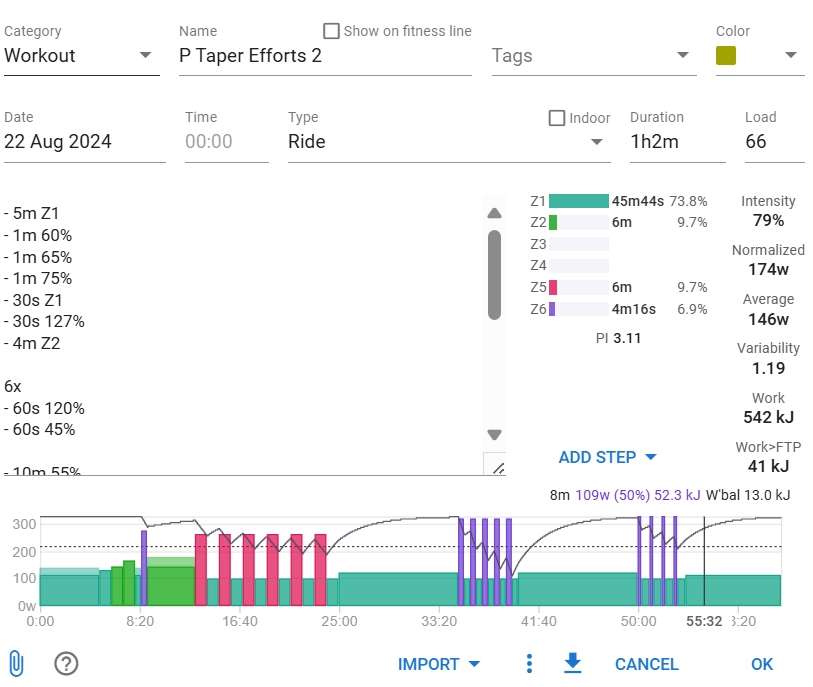

Hi David,
Despite indoor not be cheked last Thursday, August 22nd, I got not power range on the workout bellow on my Fenix 7x Pro SS.
