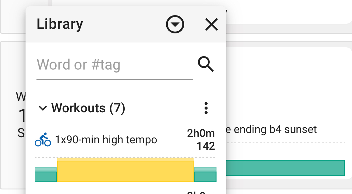

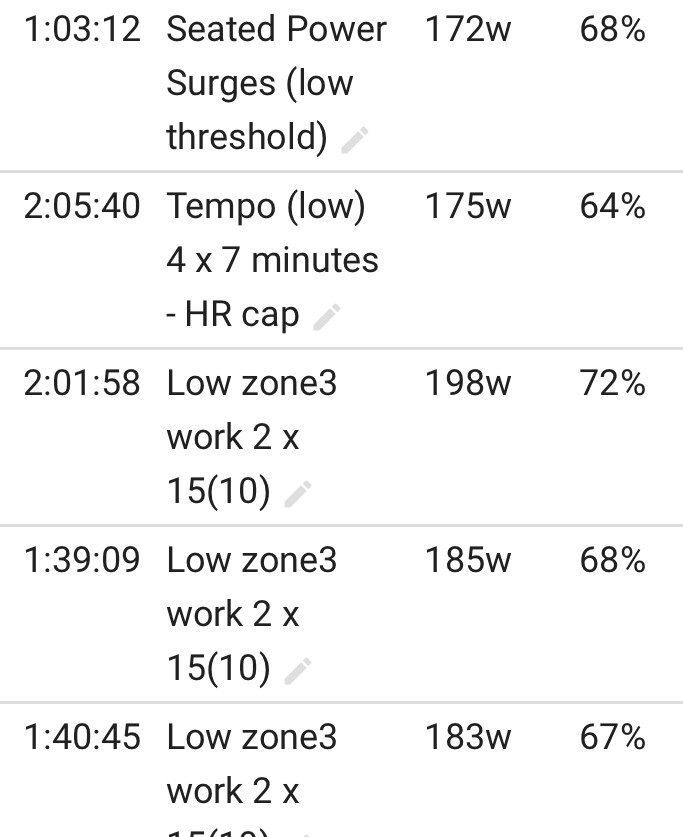

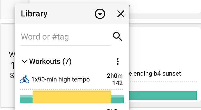

My coach taught me to think of zones divided up into thirds. But he also took some liberties with endurance (66-79%) for shorter rides and longer rides were more focused on TSS.
I could see something like
Z3.1
Z3.2
Z3.3
But he had a simple naming convention:
And
His Sweet Spot was a range around 92% or low threshold.
Above threshold work was controlled, full gas, or all out.
That was pretty effective, assuming the athlete is motivated enough to read and follow simple instructions. IMHO.
But I get it, you want to possibly customize zones - this is absolutely needed above threshold - and then apply a library without having to visit a workout and modify (my coach did some of that).
