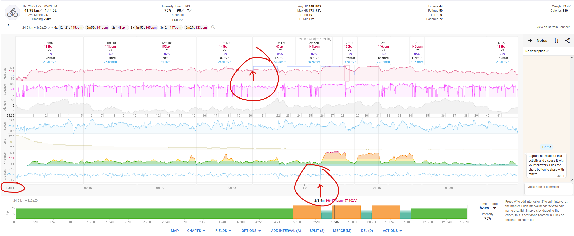

@david: here is an example screenshot with my hand-made markup:
  1. It is clearly visible, that the workout-target graph is totally out of sync, as the first two steps of the workout are distance based and the 2nd one ends in a “press lap”.
  2. Nevertheless, the actual elapsed time at the moment of actually starting the intervals is known to intervals.icu in multiple way:
  • any workout step is necessarily ends in a lap-marker, at least for Garmin devices. Hence, the beginning and end of any workout-step are ALWAYS at lap markers. The time-based-workout-target-chart do not have to rely on hypothetical (and naturally always wrong) calculated speed/pace to derive a fake (and wrong) time duration for the graph-segment. Intervals.icu KNOWS exactly the elapsed time-duration, it is just a matter of design decision to use the measured elapsed time as the basis for the workout-target graph
  • the proof for the above claim is marked up at the lower left corner of the picture: you do correctly indicate the actual, recorded time-elapsed-since-activity-start at the end of the workout interval-step…
the problem is that the rendering logic for the workout target-intensity chart does not use the actual elapsed time, but the hypothetical (and always wrong!!) calculated time from the workout description – even for distance based steps. The bugfix would be is to use the actually recorded elapsed time for
  • the actual elapsed time at all the distance based workout-steps (use either the recorded timestamp corresponding to the prescribed distance)
  • or the timestamps of the lap-end markers for all the “press-lap” marked workout steps.
