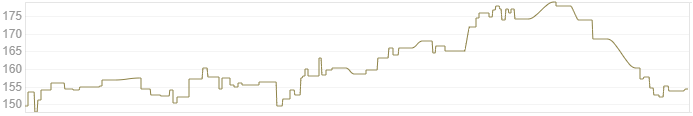

Edit: Tried uploading a CSV that blankets those 4 years with -1s only, which worked as expected… then another CSV with the 90 weight datapoints only. Same results – each of those 90 datapoints generates a lot of extra datapoints, making the weight graph look like a step function (graph is set to As Is, not Fill In):

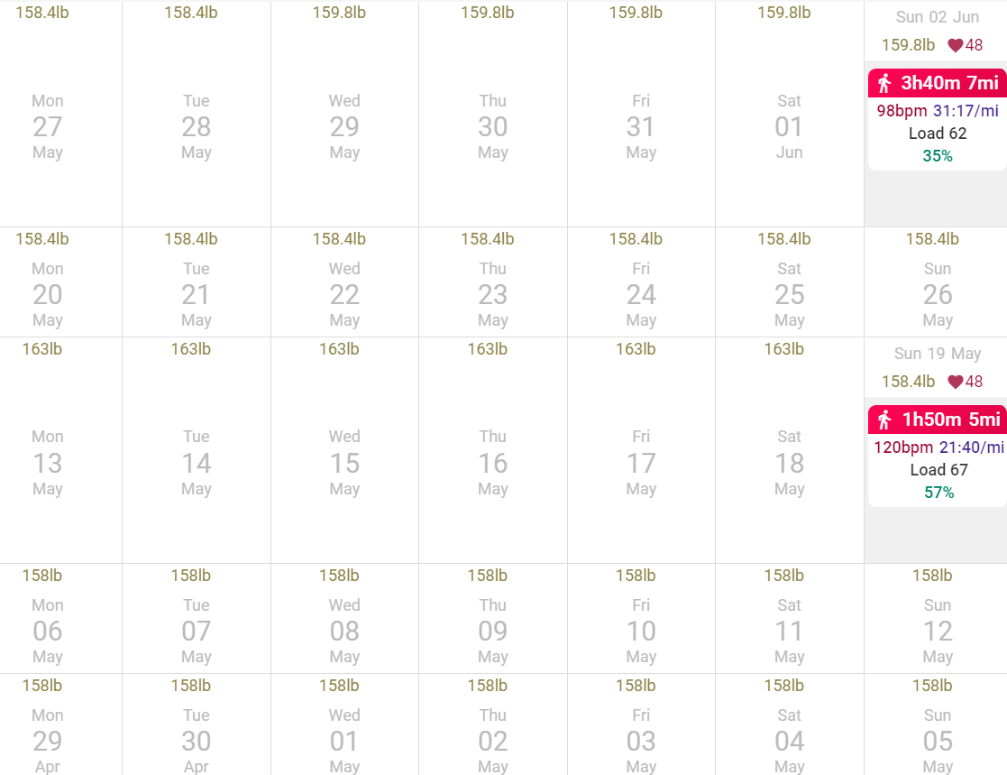

Intervals needs a weight on EVERY day with an activity otherwise it can’t calculate w/kg and other metrics depending on body weight. That’s why every day with an activity get’s the most recent weight.
That is not what I said is happening. Most days in question did not have any activities on them.

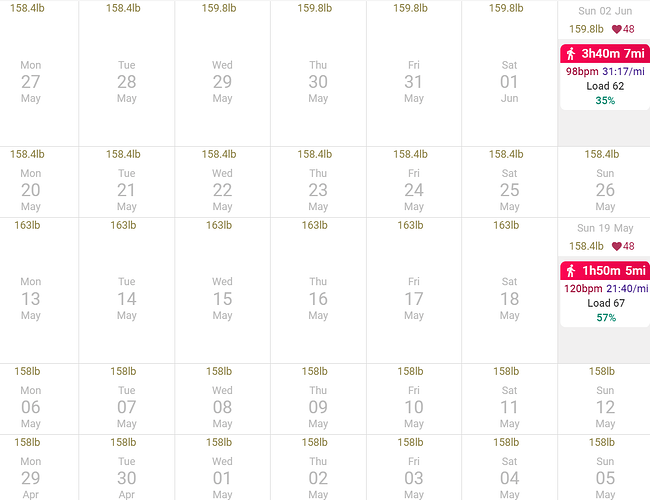

In the screenshot below – May 4, 13, and 19 are the only weight datapoints for May in the CSV, yet the entire month gets filled with repeating weight entries. This must be a bug with CSV import?
@david – IMHO, the desired behaviour that makes sense here is something like the following:
On activity creation / import or re-analyze:
  • Is there a weight value on that day?
    • Yes – use that value,
    • No – is there a weight value with a timestamp newer than the activity (in the future)?
      • Yes – interpolate (linear is probably fine) between two nearest weight values on each side of the activity (past and future) and use that value,
      • No – use the nearest past weight value.
  • After the activity is processed, discard the value (do not write into the wellness field) – or, if the wellness field entry is necessary for the activity processing function as it is coded now, use a flag to designate whether the weight value was real or calculated, fill the wellness field temporarily and then clear it after the activity is done processing (based on the flag).
I don’t think this is much more computationally intensive than the current way, but that’s just IMHO… and still doesn’t explain why days without activities get weight values set even after being overwritten with a -1 from CSV import.
