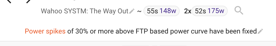

You raced above your FTP setting and that is considered ‘artefact’.
Raise the FTP on that run, and it will be accounted for.
You can update the FTP for that run from the summary at the top when you open the activiy.
Look for FTP with the pencil icon beside it and click on it to change FTP.
You may need to re-analyze from the Actions menu after the change.

That was exactly the issue. I never would have thought to check the FTP setting. A warning message for cases like this would be very helpful.
Thanks again!
There is a warning right above the charts in red text…
