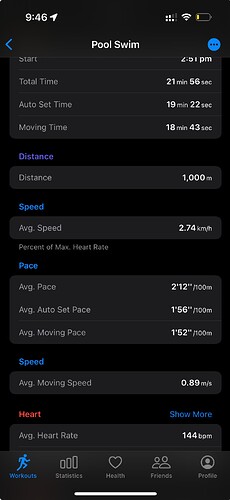

Bringing this one back to life again after reading this. Tried uploading the .fit file directly, but still getting discrepancies between Strava / HealthFit and intervals.icu. A bit more context:
  • This workout was recorded from my Apple Watch Ultra.
  • Data was extracted using HealthFit and synced to Strava and Intervals.icu.
  • I tried deleting the strava and intervals.icu activity entry and uploaded the fit file directly. Same Intervals.icu result.
Link to fit file here.
Intervals.icu screenshot:
Strava activity link here.
Healthfit screenshot:
  • notice the difference in avg pace. 1:56 autoset pace to 1:38 pace on intervals.

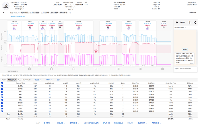

@david, I’m noticing that ICU and Garmin swim interval times and paces don’t match. I discovered this when doing a TT test (500m WU, 5x 100m tempo, 1000m TT, CD)
@david Was hoping to bring this topic back to life - I’m experiecing the same problem using the native Apple watch workout feature to record a swim, then importing into healthfit before exporting to intervals.icu. Did you find a ‘fix’?
@Errolleesw Did you find a work around for the healthfit / intervals.icu set discrepancies?
I’ve also noticed that total distance is correct - 1.6km, however sum of intervals is off?
Intervals.icu workout
Iphone auto sets - i.e. the ‘correct’ view of my session, aligning with stopwatch for 400 and 200 time trials.
Any help would be appreciated!
J
