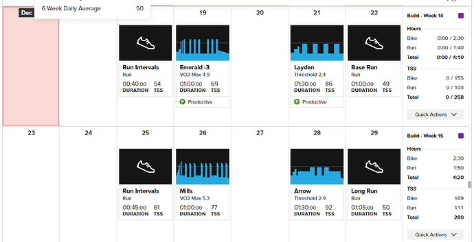

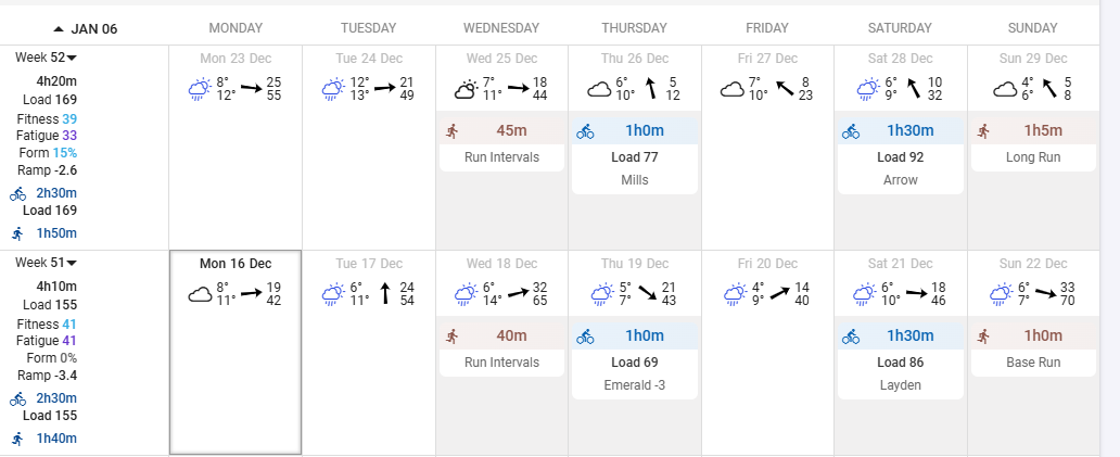

Hi @david I am still getting odd behaviour with this - the TSS is not being imported for the runs. See below next 2 weeks in Intervals vs TR:
As you can see Intervals does not import the TSS for the runs, but does for the rides - even though I have not done anything different with them. From the TR side, the TSS is right there and looks exactly the same as it does for the rides (although I assume there is something different under the hood), but it does not get pulled through into Intervals. This obviously means my fitness graph going out into the future is incorrect as it’s not including run TSS.
Unfortunately the ics export from TR does not include TSS on the runs. Here is one example:

OK that makes sense - it looks the same on TR calendar but I figured there must be something missing from what you see on this side. I’ll raise it with TR instead, thanks.
Just in case anyone else is having this issue, I got some feedback from TrainerRoad:
"it turned out to be a rather strange set of changes that happened to change the way TSS was exported in the ICS files.
This happened after some updates to our Fatigue Detection system(Red Light, Green Light), it seemed to have effected the way TSS is reported or not reported in ICS files."
Not fixed yet but at least they know what has caused it! I can’t be the only one…
