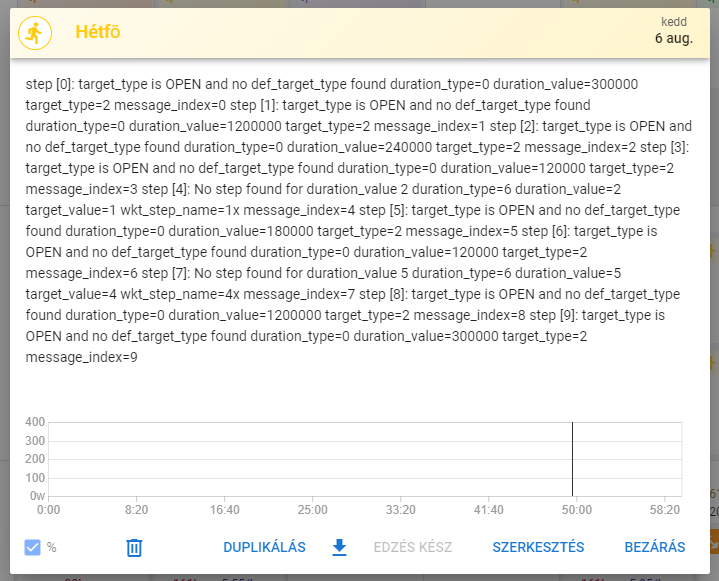

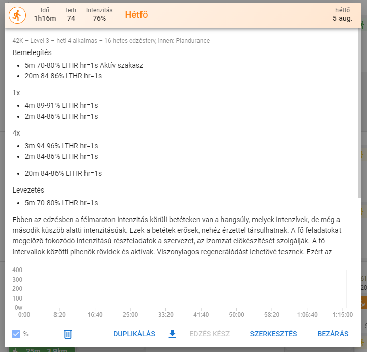

I exported a bunch of my planned workouts (saved as .fit files). When I import any of these by going to a certain day / add calendar entry / running / import / done then all data is missing.
I am attaching a screenshot of the original workout and then how it appears when imported from a .fit file.
How can I fix this issue? Is there any other format that’s recommended for exporting scheduled workouts?
Original workout -
Imported workout -
