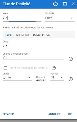

Hello, I’m trying to integrate a CSV file from a test using Pairfs Zonex for threshold estimation.
Here’s my method, which I suspect isn’t correct:
I download the CSV file from the intervals output in the data section.
I open the CSV file from the Pairfs software and extract the columns with breakdowns, etc.
I create custom streams with the exact same name as the CSV file.
And I get the message: “No custom activity stream found for column [VIn (L/min)]”.
I don’t understand where I’m going wrong.
Thank you in advance.

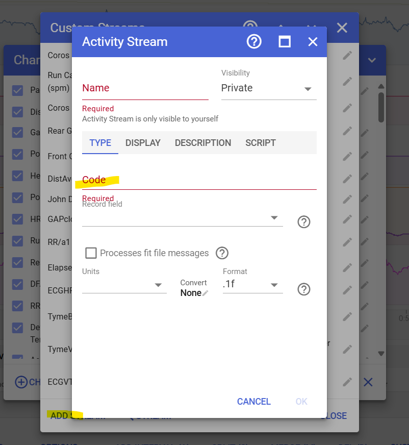

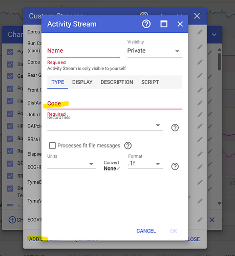

You need to create the ‘placeholders’ as Custom Streams first in Intervals.
Create the Custom streams and then use the exact same code-name as the column header in the csv.

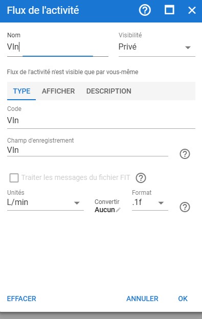

Thank you for your message. I must be a complete idiot, or the error is right in front of me and I’m not seeing it, but I’m still getting the same error message.

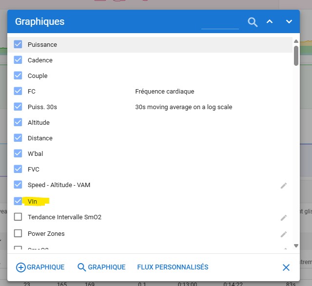

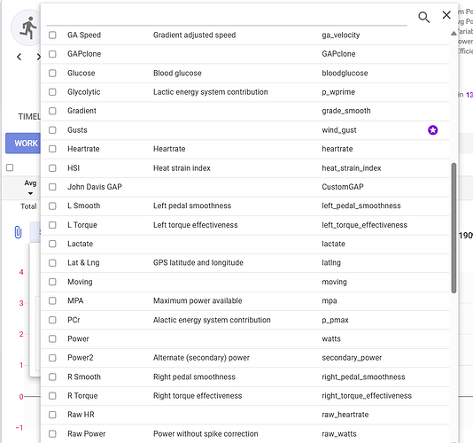

Can you select your created custom stream(s) from this dialog?
If they are selectable there, then they are created succesfully.

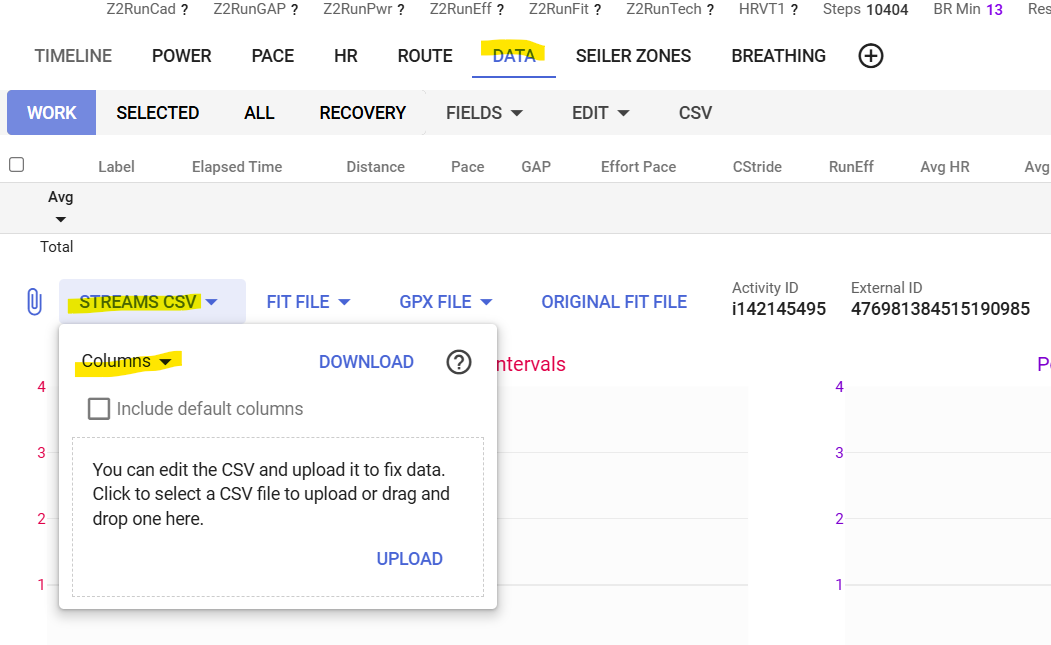

Download an example csv from that dialog, with your custom stream selected, and double check the csv header. Add some data in the desired column and reupload.
If all that works, then you should be able to find out why your csv is not accepted.
PS: check the csv in a pure text editor! Saving as csv in a spreadsheet may alter separators.

Thanks, that’s great—it works now. I started over from the beginning; I think there was a problem exporting the CSV between Numbers (Mac) and Excel with the , and ;
