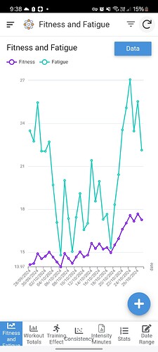

Hi All,
I made myself a little app so I can quickly see the metrics that are important to me. Its not a replacement for the website, just a little adjunct.
I used appsheet connected to a google sheet that downloads the csv data from intervals when I do log a workout on strava.
here are some screenshots. Appsheet is “no code” but it is a bit clunky and frustrating at first. But it is a way to simply represent whatever you want in a small-screen-friendly way
