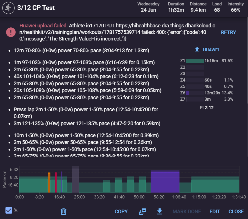

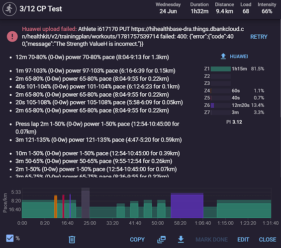

Hi @david , I found this persistent error when trying to upload workout to Huawei.
The overall syntax is:
  • 12m 70-80% power, 70-80% pace
  • 1m 97-103% power, 97-103% pace
  • 2m 65-80% power, 65-80% pace
  • 40s 101-104% power, 101-104% pace
  • 20s 105-108% power, 105-108% pace
  • Press lap 2m 1-50% power, 1-50% pace
  • 3m 121-135% power, 121-135% pace
    -10m 1-50% power, 1-50% pace
  • 3m 50-65% power, 50-65% pace
  • 2m 1-50% power, 1-50% pace
  • 3m 65-75% power, 65-75% pace
  • 3m 65-80% power, 65-80% pace
  • 12m 103-112% power, 103-112% pace
  • 5m 1-50% power, 1-50% pace
  • 8m 65-80% power, 65-80% pace
If I try to cut it down to these then it’s fine:
Update: the culprit is on the walking segment (e.g. 5m 1-50% pace), if I change those to absolute pace range (e.g. 5m 13:00-10:00 Pace) then it’s fine
