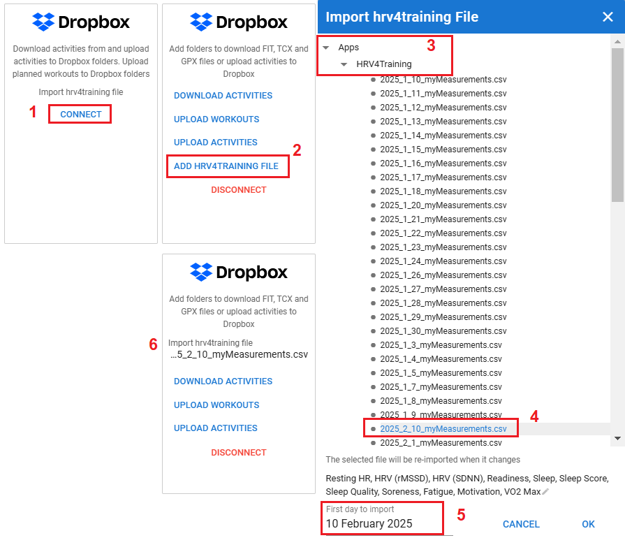

I disconnected my account, then followed these steps, to return it to normal.
Before:

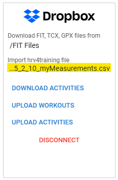

Download FIT files from the /FIT Files folder. This was to bring Zwift files into Intervals before the direct integration) :
After reconnecting - 6 steps to connect to the file:

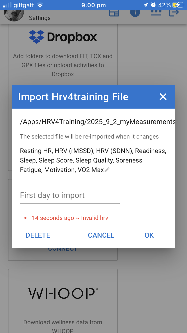

i have realised that intervals is not importing my data because it believes it is invalid. is there any way i can find out more? - debug mode?
Look at the original file from Dropbox and refer to the HRV column. Find out which row is the issue.
Likely it’s a negative value or a super large number that is not allowed.

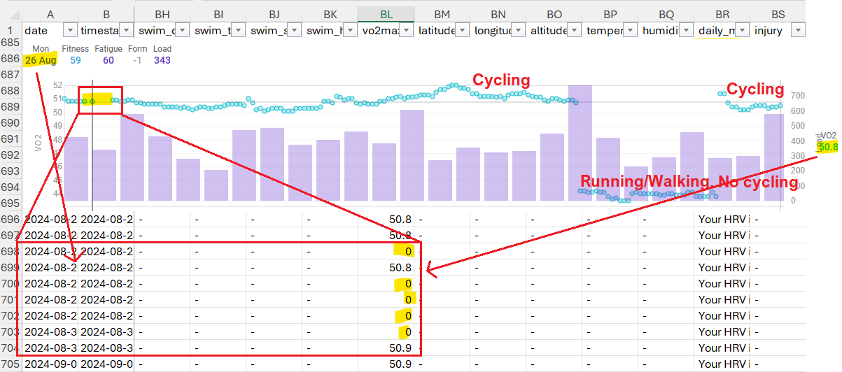

I have some days where VO2max is reporting zero (see the highlighted cells on the csv file).
On a separate issue, because you raised the query on VO2max:
I don’t know why it’s zero, and I don’t really care because the value is estimated and not measured. It’s underestimated by 8-11 (ml/m/Kg).
Many users/supporters have mentioned that their Garmin VO2max value is not being populated, but I have noticed now that it’s actually the HRV4Trainingvalues. Where HRV4T gets it? I have no idea; I would assume from a linked account.
It doesn’t correspond with Garmin values, even though the trend/drop in values (from the 50s to the 40s) coincides with my running/walking and not cycling in January.

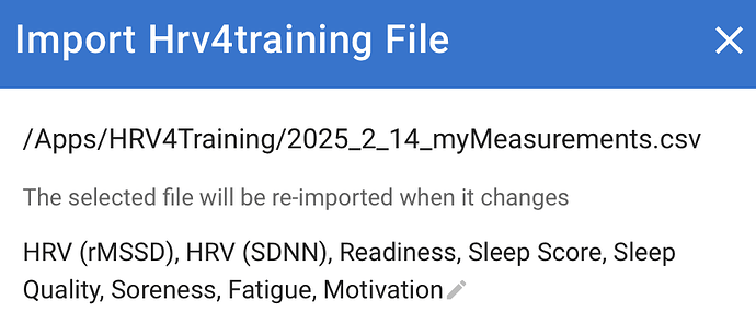

Try REMOVING VO2Max data from being imported (click the pencil icon)
