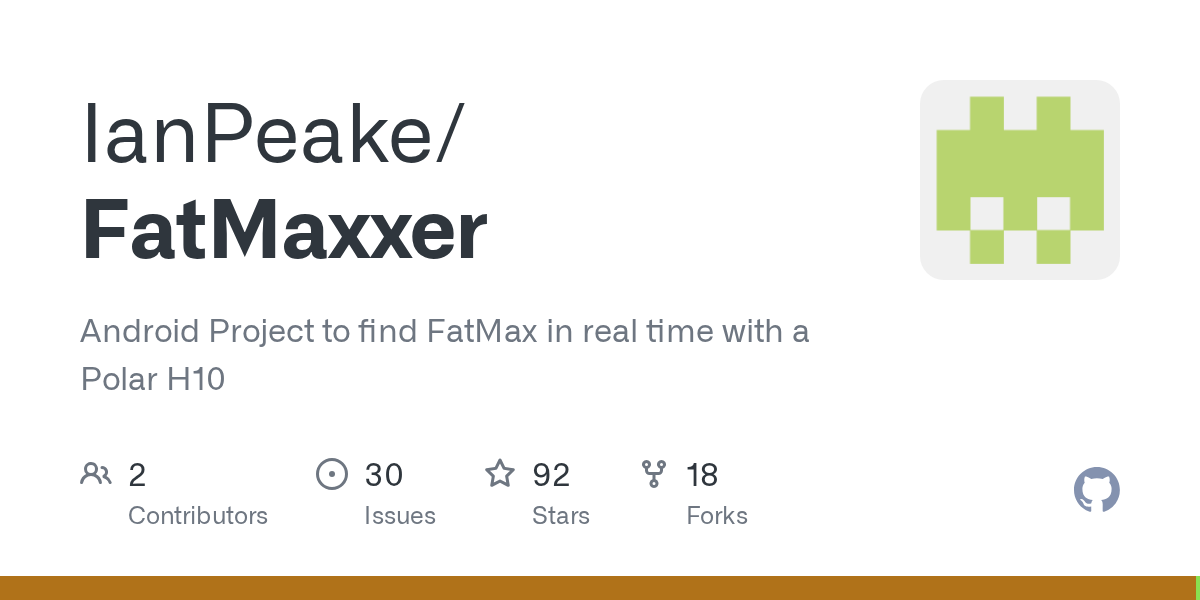

HRV during exercise is still in very early development phase, so it’s difficult now to get something meaningfull from the data without a lot of background knowledge. You can use the download from Intervals and let it replay in FatMaxxer to get your DFA-a1 curve for the entire workout. Thus if you planned an enedurance ride, you can check in FatMaxxer if your DFA-a1 was around 0.75, which represents VT1 intensity. This same functionality will likely become available in Intervals when David finds the time for it. It’s not a priority now given the fact that it is still in development.

Any idea what to press in FatMaxxer to do that? Can’t see much in the way of buttons etc!
You need to subscribe as a Tester and activate Developper mode for that function to become available. “Import and replay RR log” from the menu top right. Goto the Github page and anounce as a tester.
You may need to slightly modify the csv file from Intervals. It should only contain Timestamps with the RR interval.
I downloaded the beta version (and joined as a tester), but I’m not seeing anything in the menu beyond “Quit” and “Search for Polar devices”. Odd.
No matter, was only interested on an academic level.
Did you enable Developper mode in the settings at the bottom of the startpage?

Ahh, it’s a scrolling panel. Thanks, I could only see one option there and there was nothing to indicate it moved!
Sorted now.

The read-me file on Github explains what you are looking for I believe.
It seems to me the current primary use is having the live DFA alpha1 value on the screen to know that when you want to be in the “aerobic” zone you actually are.
I recently found another use (maybe). I was ill for 3 days and my first rides back were very easy using Fatmaxxer and it was very clear that my power at which I stayed above 0.75 was hugely reduced. I guess there’s the possibility that without this I may have worked too hard and my autonomic systems weren’t ready for it.
Now, nearly 2 weeks later my “above 0.75” power seems to have reverted to what it was pre illness.
