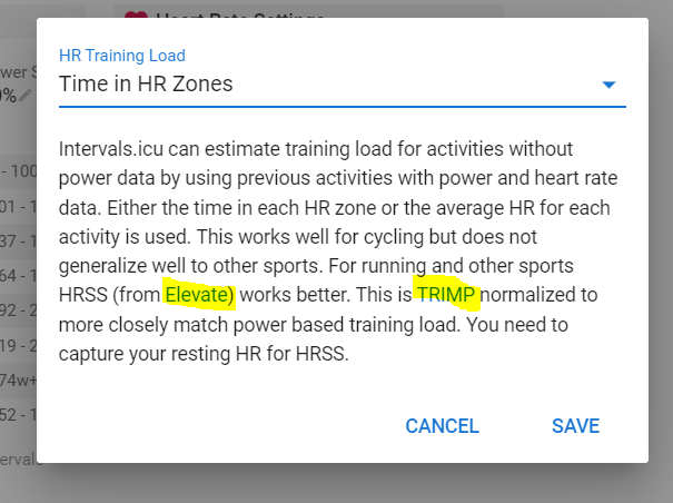

Can someone give me a layman’s definition and explanation on what HRSS (normalized TRIMP) is? I see under all my swim, bike and run activities that it was set to Average HR, however, recently saw posts on HRSS and that it was a more accurate measure (or something like that). I train by HR as my Number 1 metric so want to make sure it is being accurately calculated in Intervals under my TL. Thanks.
HRSS = Heart Rate Stress Score - A TSS (load) figure assigned if traditional TSS cannot be determined due to absence of a power meter.
TRIMP is “Training Impact”
In this instance your Training Impact is measured by your heart rate (HRSS).
So basically it’s assigning a ‘load’ figure to your workout if you didn’t have a power meter to measure the load.

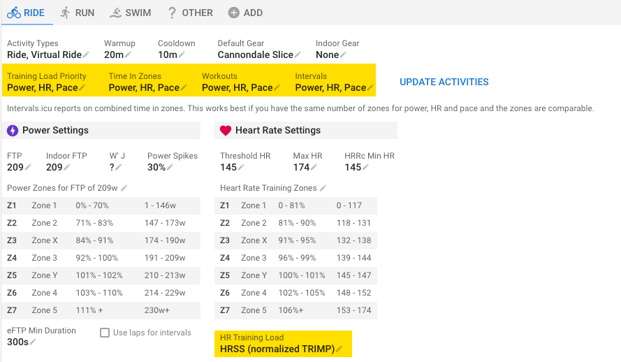

Thanks, I’ve changed in Bike settings to the following. Does this look right Olly?
Yep same settings as mine apart form I use time in HR zones for HR load calc (but I never get a calc from this I use as I have consistent power across all my bikes using the same power pedals)
