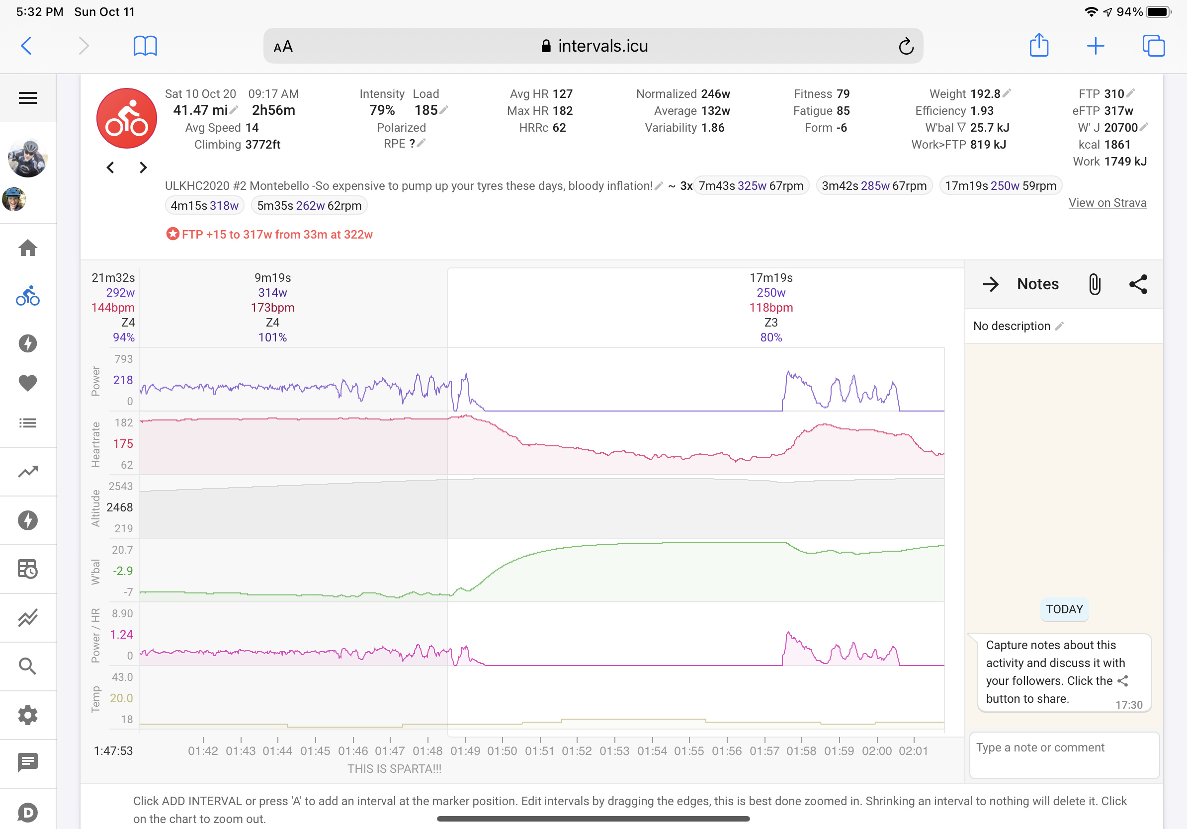

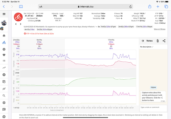

I was very excited to go back to an older activity and see this metric, but on my ride yesterday on the same segment I did not see it again. Is HRRc gone?

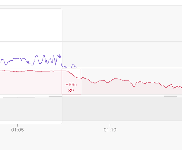

It’s not gone :slight_smile: You have to reach at least threshold HR to get an HRRc measurement and you didn’t quite get there on that ride. It keeps the best (highest recovery) from all the qualifying drops. I implemented this after reading some stuff about LSCT tests and was hoping to get something that could be used in a similar way. Thats why I chose 60s and an easy to understand “how much did HR drop” result.

I was at/above LTHR for the duration of the climb, 46+min, but really close, I guess I need to be above it for a little while. FTP bumped up 15W as a result of this effort, definitely significant for me.

You just have to reach threshold HR to get an HRRc measurement. 1 sec is enough.
