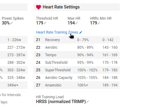

Right now I have my MaxHR set from a race in another sport but I’m training a lot in cycling now. In i.icu the HR zones seem about 10BPM higher than what my nose breathe/RPE feels like, however I do have a deviated septum so I can’t breathe through my nose super well, maybe that changes things. I have a 20min test for FTP number set for my power zones but I think it’s better to look at HR when doing Z2 so I’m trying to make sure the HR zones are correct.
Actually, it seems like changing MaxHR doesn’t change the HR zone numbers at all? It’s actually LTHR that changes the zones but I’m not sure where the number came from. Should I do a 30min LTHR test in 4 weeks at the end of my next deload week? should I do a max HR test (3min?) and update my max HR to be cycling specific or does MaxHR not really matter as it doesn’t seem to change the zones at all.
Yes, zones in Intervals.icu are set based on threshold values (FTP, Threshold HR, Threshold Pace). You can edit your zones in the Settings page; There are many preset zone models you can choose from, or even define your own:
MaxHR doesn’t affect zones but affects other metrics in the platform (e.g., HR Load from TRIMP).

That’s what I do and in addition I’ve lowered the bottom of Zone 2 HR on my graph based on my RPE and ventilation. There is plenty of support for these methods over strictly heart rate and/or power. In my case, my chart said 128. I changed it to 122 and found a big improvement in my decoupling over 1 to 2 hours. The effort and time required to get my heart rate comfortably above 128 and keep it there was too high and it kept bouncing around and wanting to jump into Zone 3 with the slightest provocation.
can you explain more? are you saying in your settings>HR you lowered the low zone 2 number from 128 to 122 ? or you did this in a different area?
